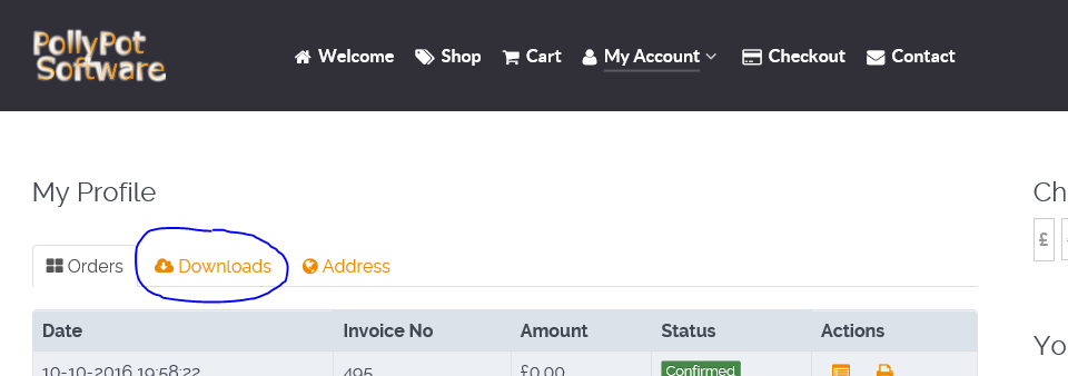

Where Is My User Key and/or Software Download?
On the main website click My Account. If you are logged in, 3 tabs will be displayed: Orders, Downloads and Addresses. Click the Downloads tab and you will see your User Key listed next to your order and download options.
If you are not logged in, you will be promoted for your login credentials that you created. Once logged in, you can do the above.
downloads screen
