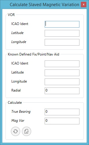

Calculate the Slaved Mag Var
  1. Locate a chart that contains the VOR/VORDME to be updated and also contains a radial bearing from the VOR/VORDME to another nav aid.
  2. Enter the ICAO Ident of the VOR/VORDME in the VOR section.
  3. Enter the ICAO Ident of the other nav aid identified in step 1 in the Known Defined Fix/Point/Nav Aid section.
  4. The Latitude and Longitude will be automatically populated.
  5. Enter the radial identified on the chart in step 1.
  6. Click the Calculate Slaved Magnetic Variation button and the True Bearing and Mag Var fields will be populated.
  7. Click the Save button. Note this will create a Custom Nav Aid using the existing VOR/VORDME data but with an updated slaved mag var.
