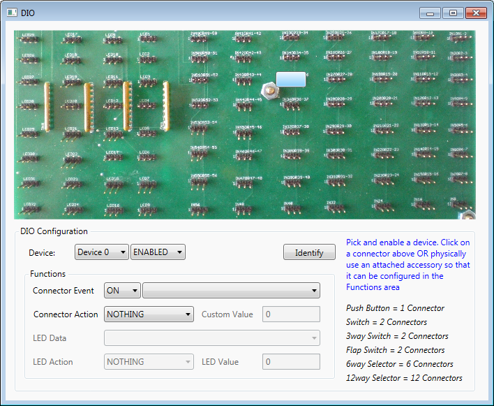

DIO
  1. Connect your accessories to each of your DIO boards, ensuring that you leave sufficient number of unused connectors depending upon the accessory used.
  2. On the Status Tab of the Interface, click the "DIO" button (note the "DIO" button will be disabled if no DIO boards are attached/detected). The following screen will appear:
    dio
  3. Pick the device to be configured and enable it.
  4. Use the attached DIO accessory (Push Button, Switch etc) and the blue selection box will move to highlight the activated connector on the DIO picture. The Connector Event and Action fields will become available for configuring the selected connector.
  5. LED's (and the other connectors) can be configured by clicking on the required connector on the DIO picture. The blue highlight box will indicate which connector has been selected and the LED Data and Action fields will allow configuration of the selected LED.
