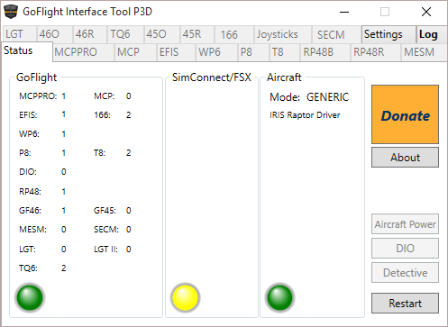

3) The interface should appear:
status
4) You can click on the "tabs" to change what is displayed.
5) The LED’s indicate the states of the interface:
Green: OK, connected and running (bright or light green)
Light Red: Off
Flashing Light Red: Attempting to start
Bright Red: A serious error has occurred which may require an interface restart
Yellow: An error has occurred which is for information only (check Log)
Flashing Green: Data is being processed
6) The restart button will restart the interface and attempt to reinitialise and reconnect with the hardware, FSX/Prepar3D and the current aircraft. This is useful if you have unplugged and re-plugged some hardware.
