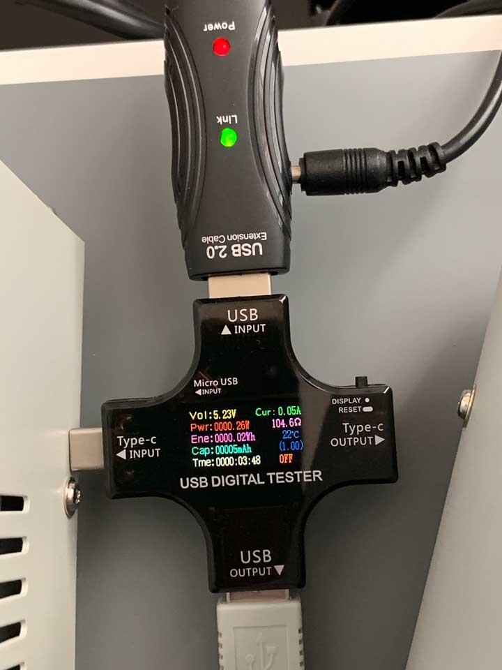

  • If anyone is having additional GF module power cycle issues, I found this USB (and USB-C) tester to be extremely helpful in diagnostics:
    The device is cheap $18.99 from Amazon: https://www.amazon.com/gp/product/B07X3HST7V/ref=ppx_yo_dt_b_asin_title_o02_s00?ie=UTF8&psc=1
    It will show you voltage drops, current load, resistance ... it was very helpful in identifying a few high load GFModules and controllers and problematic power from hubs and/or cables/connections.
    Cheers, Rob.
