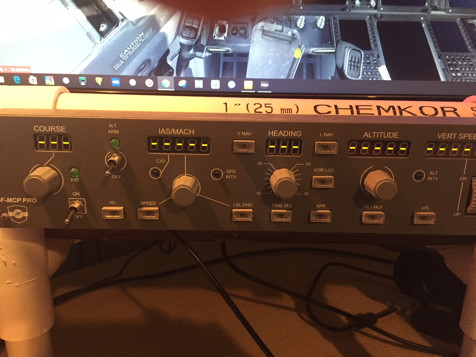

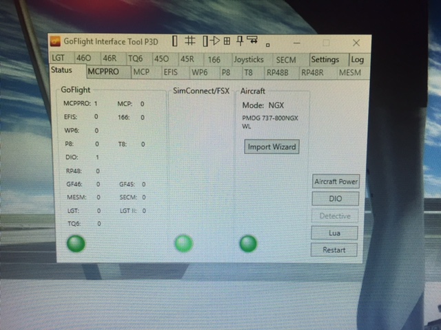

  • MCPpro still showing dash lines, defaultP3D.gfc
    [GFMCPPRO_1]
    Mode=COMPATIBLE
    BrightLevel=8
    what I'm I doing wrong, also showing in PD3 V4 menu bar

  • This is very odd as the NGX is refusing to send any data to GIT.
    Can we go to basics and test with the default beach baron. Load it up to the VC, start GIT and click FS Default on the MCP PRO tab. Quit GIT and then restart GIT. Does the MCP PRO work OK?
  • did load with Baron, loaded GIT with default, everything works
  • Try upgrading to P3D v4.1 and the latest PMDG updates out the other day.
  • sorry but did that too
  • I'll have to do a fresh install at my end and see if I can re-create the issue.
  • OK, I've done that and it worked first time with P3D v4.1 and the latest NGX.
    Can you uninstall GIT and install it in C:\GoFlight and not in Program Files (x86) in case its a security issue of some sort. You will need to copy GFDev.dll from C:\Program Files (x86)\GoFlight into C:\GoFlight.
    If that doesn't help, do the following so a console log is produced:
    In Documents\Prepar3D v4 Files, edit (or create) the Simconnect.ini file so it looks like:
    [SimConnect]
    level=Verbose
    console=Yes
    file=C:\SimConnect%01u.Log
    file_max_index=9
    Start GIT and P3D, load up the NGX and get to the VC. Then quit FSX. A log file will be created in C:\ (or many log files). Copy these and attach to this thread please.
  • edited October 2017
    OK, having looked at the log there are no errors or exceptions, but the NGX or Simconnect is not sending the data to GIT.
    I found the request being made by GIT to receive the data which showed no errors:
    1140.01972 [516, 18]RequestClientData:ClientDataID=1313306673, RequestID=100, DefineID=1313306674, Period=3, Flags=1, origin=0, interval=0, limit=0
    But then there should be a continual stream of messages like this that indicate the NGX is transmitting the data to GIT.
    170.98997 [321] ClientData: RequestID=100 DefineID=1313306674 dwSize=816
    There isn't a single message sent, so GIT cannot do anything. This indicates either:
    - A damaged Flight Sim / Simconnect installation
    - A damaged NGX installation
    - One of the issues raised in the FAQ entry "My MCP PRO or MCP Advanced is not updating its display (just showing zeroes)" here: https://www.pollypotsoftware.org.uk/support/user-guide/user-guide-git/16-installation/70-faq-goflight-interface-tool.html
    - A clash with another add-on (unlikely, but it may be worth disabling as much as possible [exe and dll] and trying again)
