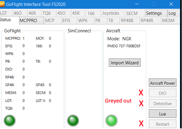

The GIT works partially on some of the generic aircraft in MFS2020 but I am having issues using it with PMDG 737
The MCPpro transmits data to the 737 aircraft when turning the knobs and switches on the MCP but the MCP display is stuck at 257 and 0000’s for everything else and fail to change.
I have installed and reinstalled GIT and have made hundreds of attempts to find a solution but I can not.
The GIT interface seems to function normally for Generic aircraft but when I load PMDG 737 many of the menu items are greyed out.
When Loading the 737 the GIT Status Menu DIO - Deactivate - Restart are all greyed out

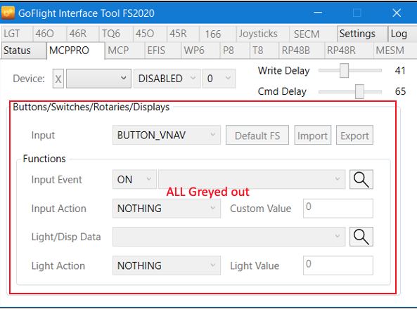

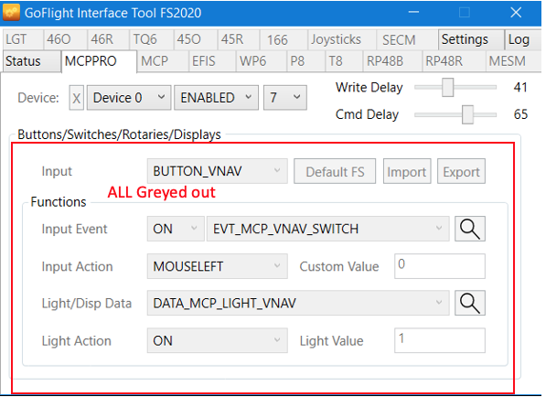

So are the menu items for buttons/switches/Rotaries/displays on GIT Mcppro menu
This is only the case when I load PMDG737 aircraft. the menus are not greyed out with generic aircraft

LOG FILE AFTER LAUNCHING PMDG 737
15:49:00 GoFlight Connection Starting.....
15:49:00 SimConnect Connection Starting.....
15:49:00 SimConnect Message Processing Started
15:49:00 GoFlight Connection Started
15:49:01 SimConnect Connection Started
15:49:01 Aircraft Connection Starting.....
15:49:01 PMDG SDK option is OK in FS2020
15:49:01 SimConnect: Event Received: Aircraft Type Changed
15:49:01 SimConnect: Event Received: SIM, 1
15:49:01 SimConnect: Event Received: PAUSE, 0
15:49:01 GoFlight Connection Starting.....
15:49:01 Synchronising Switches & Selectors .....
15:49:01 SimConnect Message Processing Finished
15:49:01 SimConnect Connection Starting.....
15:49:02 Creating Bespoke Vars
15:49:02 Bespoke Vars Created
15:49:02 Importing Bespoke Variables
15:49:02 Bespoke Vars Assigned, Importing Bespoke Events
15:49:02 Bespoke Events Temp Imported
15:49:02 Bespoke Events Imported
15:49:02 GoFlight Connection Started
15:49:02 SimConnect Message Processing Started
15:49:02 Synchronising Switches & Selectors: Waiting for SimConnect .....
15:49:03 SimConnect Connection Started
15:49:03 Aircraft Connection Starting.....
15:49:03 SimConnect: Event Received: Aircraft Loaded/Flight Loaded
15:49:03 SimConnect: Event Received: SIM, 1
15:49:03 SimConnect: Event Received: PAUSE, 0
15:49:04 WinSock: Connected To 127.0.0.1 On Port 27016!
15:49:04 LUA Processor: Started!
15:49:04 Aircraft Connection Started
15:49:04 Simconnect Version: 11.0.62651.3
15:49:04 Aircraft FullName: PMDG 737-700BDSF
15:49:05 Synchronising Switches & Selectors Complete
