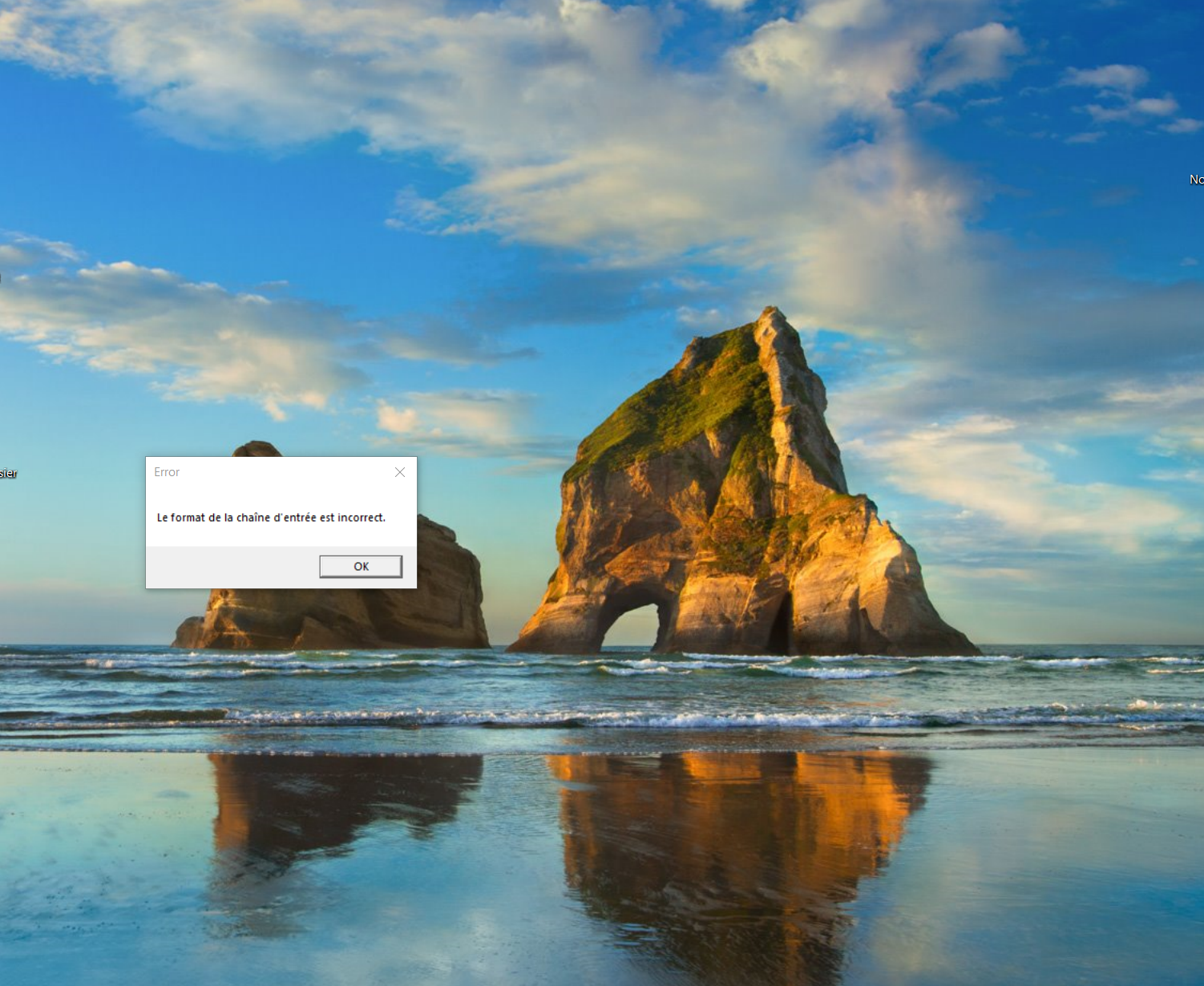

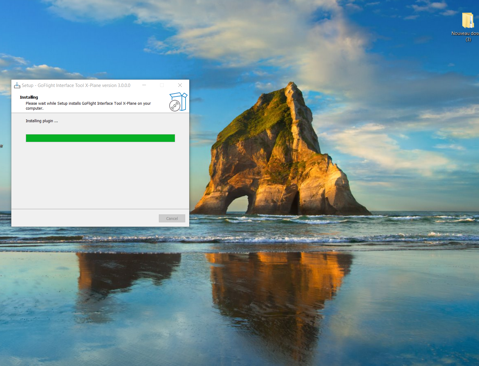

I reinstalled 2.0.16.3 with the patch 'Plugin Work In Progress', but this one also no longer works, keep getting popup that there is a new version, but also window saying 'Object reference not set to an instance of an object.
When clicking OK on the new update I get an Application Halted.
Git 3.0.0.0
the process stops there and the git pluggin folder is not installed in XPlane 12 /resource/plugin
w10 -
thanks for your help
Roland
with this message
