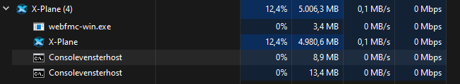

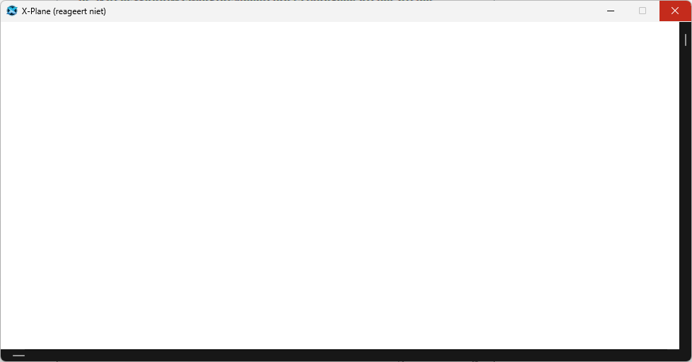

  • Correction: after clicking on OK on all the messages for two loops, it seems to work. However, can this trigger a console window?
    Or is this due to something else?
