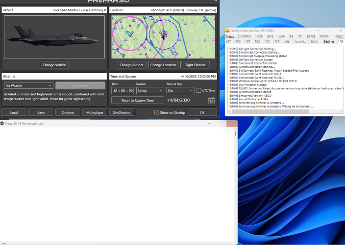

when starting GIT that I do in administrator mode, an empty window named Prepar3D v5 is created which quickly does not respond.
if I try to close this window, I have a menu (windows host console does not respond)

Looking at the log lines during this boot, the window is formed at the connection line to fsuipc, with this error message:
FSUIPC: Connection Failed: No connection could be established because the target computer expressly refused it 127.0.0.1:8385
