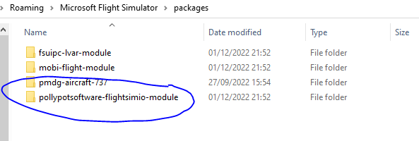

You have either not installed the WASM module into the community folder or not included the folder when you unzipped. It must be installed as per this example image:

This is what is in my community folder.
Uninstall GIT and delete the GoFlight directory and the setup file from the community folder.
Install GIT into Program Files\GoFlight. After this check if the directory "pollypotsoftware-flightsimio-module" exists in the community folder. If it doesn't, download from your account the file "GIT FS2020 Module (If Needed).zip" and unzip the contents of this file into the community folder which should not contain the directory "pollypotsoftware-flightsimio-module".
See this for further information: https://www.pollypotsoftware.org.uk/support/user-guide/user-guide-git/16-installation/263-installation-fs2020.html
