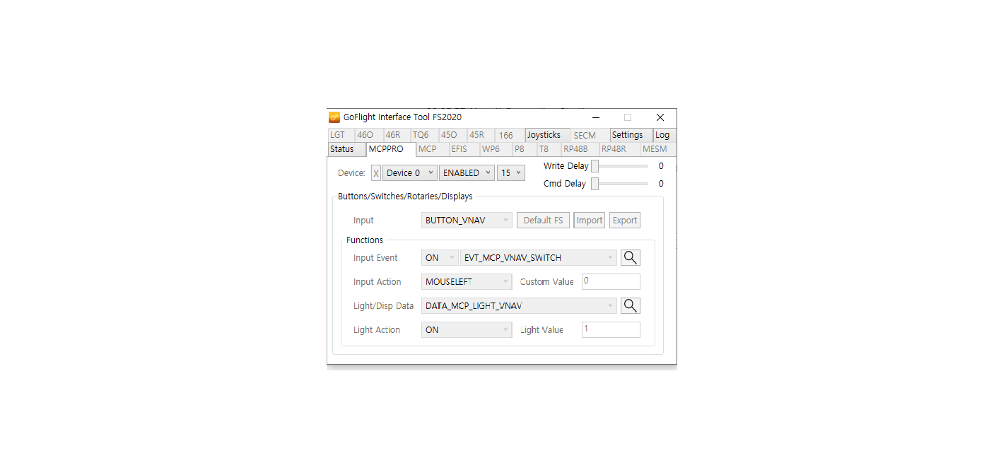

  • Set the Write Delay and Cmd Delay to 0 on the GIT MCP tab. If that does not work, please copy and paste the GIT log into a file and post on here. Include all of the log.
  • Thank you for your reply. As you mentioned , i tried. but it didn't work.
    For your informaion, i attached the screenshot.
    please let know us how can i fix this problem.
    Thank you.

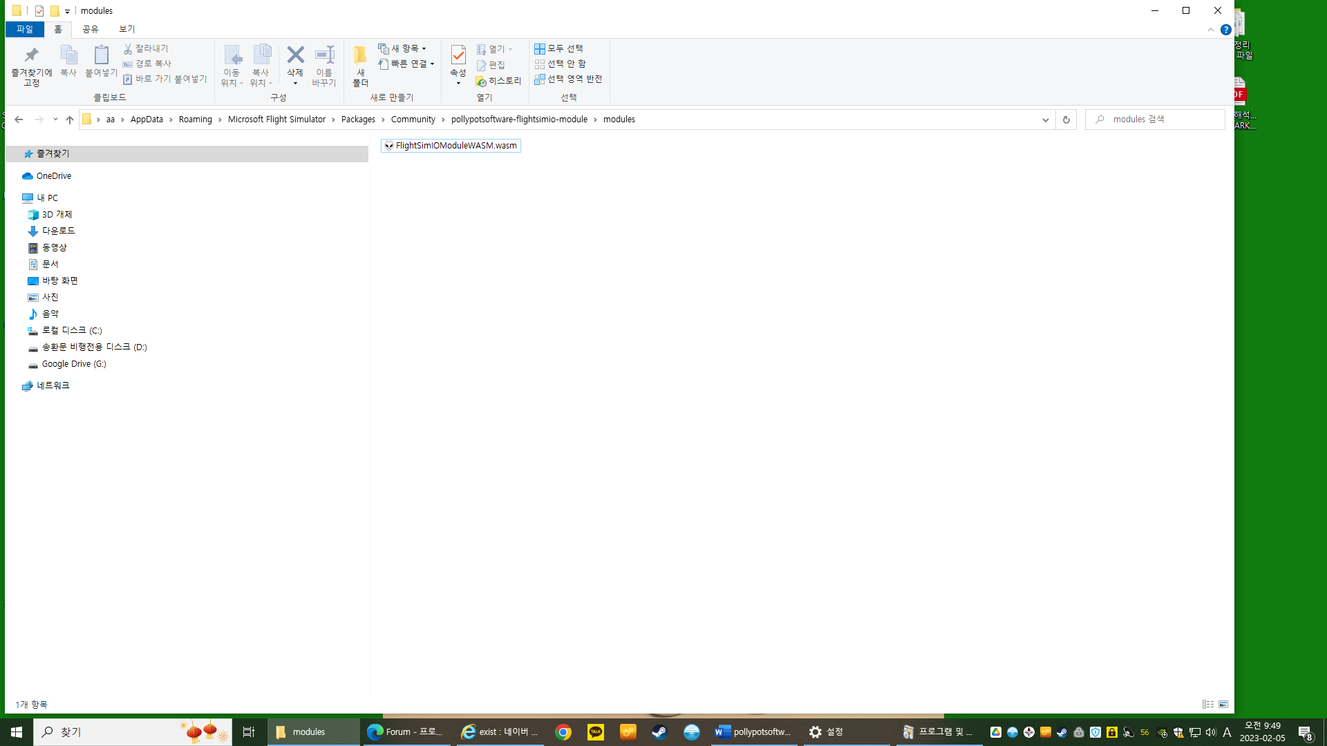

  • It looks like you do not have the GIT WASM module in your community folder. Can you check that you have pollypotsoftware-flightsimio-module installed in your community folder. If not download it from your account and unzip into your community folder.
  • edited January 2023
    i checked it and there is "pollypotsoftware-flightsimio-module" in my community folder. still same problem. not working my mcp pro.
    i have attached several screenshots for your understaning. please check it.

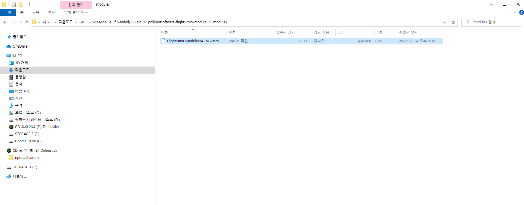

    but how can i download GIT WASH module and intall it manually in my community folder.
    even though i downloaded GIT WASH module, it requires another action..
    Also i don't know how can i have activated the GIT WASH module.
    please see the attached file.
  • You have the correct zip file. You need to unzip the whole folder into your community folder, not just the file in your picture. The following link details where your community folder can be found: https://helpdesk.aerosoft.com/hc/en-gb/articles/5023507568925-How-to-locate-the-Community-folder-in-Microsoft-Flight-Simulator

    i found out that GIT WASM module located in my community folder under the directory called pollypotsoftware-flightsimio-module\modules is dated 27th January 2023 as below the screenshot.
    please advise how can i fix this problem.
    Thank you.
  • In FS2020, enable developer mode. Once enabled, move your mouse to the top part of the FS2020 window to show the developer menu. Click Tools, then Packages and confirm you see "pollypotsoftware-flightsimio-module" listed and its status is Registered and Mounted.
