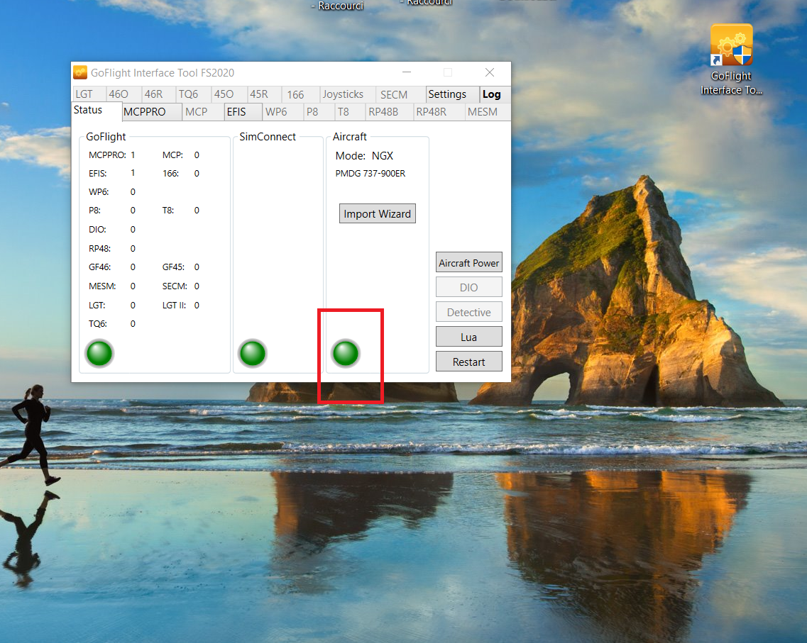

maybe it is not necessary to import a file here is what I have see photo but the MCP don't work
''Make sure you have ENABLED the MCP Pro in GIT.'' ok the picture above

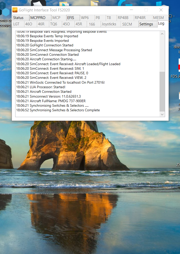

"Also check in the log for an entry confirming the PMDG SDK is ok." I don't know where to see this message
see the log texte

To enable the data communication output, you will need to open the file
737_Options.ini that is located in the 737 persistent storage folder.
For Microsoft Store distribution, this folder is located at
%LOCALAPPDATA%\Packages\Microsoft.FlightSimulator_8wekyb3d8bbwe\Lo
calState\packages\pmdg-aircraft-737\work\.
For Steam distribution, this folder is located at
%APPDATA%\Microsoft Flight Simulator\Packages\pmdg-aircraft737\work\.
Once this folder is open, add the following lines as required to the bottom of
the file:
[SDK]
EnableDataBroadcast=1
Try again, if still no good, check the above again and see if it has been turned off.
ok I did it two times
the only difference is that this green point dot is now blinking
