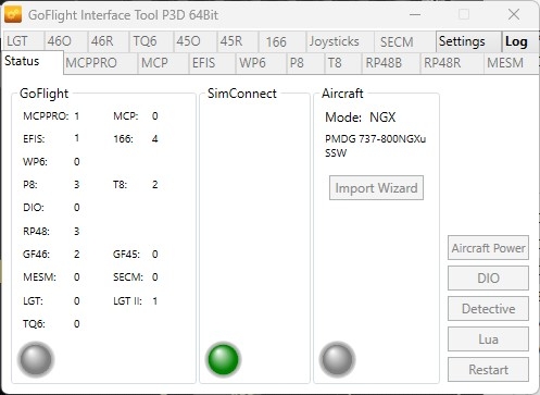

Hello support team,
for about 1 week I do have the problem that the GIT works well and freezes upon starting after I have used for about 2-3 times. I than have to delete the configuration file and re-program. It again works and freezes again upon start after I have used (started) the programm 2-3 times (normally after a new PC- and P3Dv5 start) and only can get it to work again by re-programming the GIT.
I had this problem in the past if one of the GF-devices had changed the device-no. Normally I just restart the PC and the GF-modules would be back in its original order. This time none of the GF-modules have changed the device-no., everything seems to be fine. I'm also programming 3 different Joysticks but can't find any reason why they should cause any problem.
What could be the reason or how and where I can find an information about the possible cause?
Thank you for your support.
Detlef Poese
