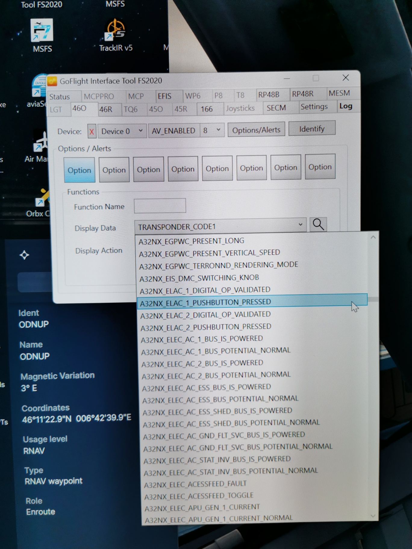

  • Preset (var, events) window:
    After assigning some presets to the GF RP-48 buttons I selected the GF-46 to assign some XPNDR presets. To my surprise the preset window listed custom events and var! In other words: It was filled with many aircraft specific presets. Going back to the RP-48 again only the standard presets were listed!
    Should not all events, var be available for all GF HW?
    Best regards, Guido
  • I don't understand what you are saying. Can you provide some screenshots please?

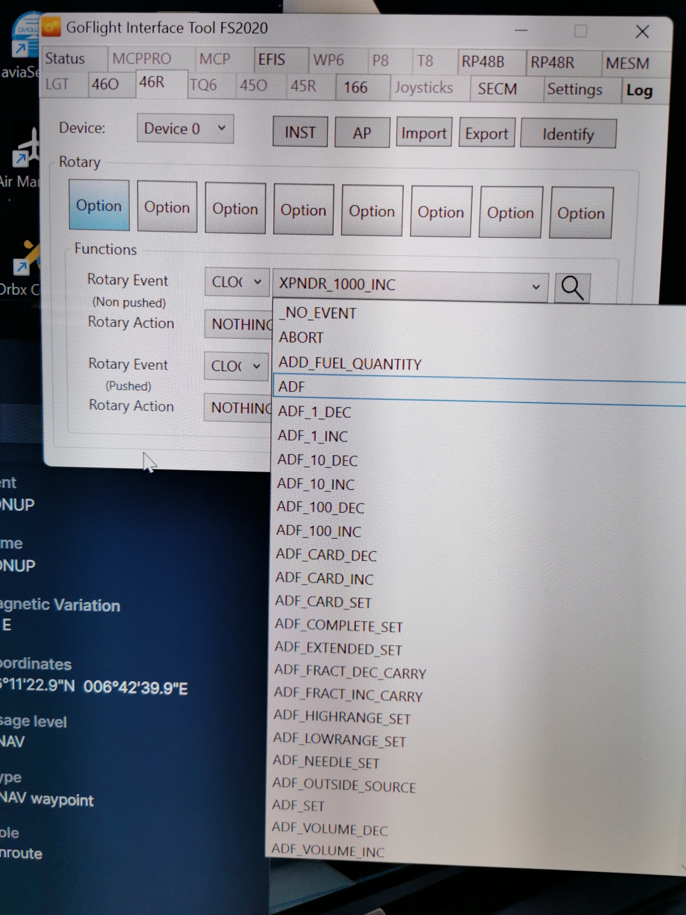

  • Thanks for feedback. I attached the tow different events/presets lists when opening RP-48 buttons and rotary.
    Unfortunately I have also only limitted options when opening GF-46.
    Rgds, Guido
  • Display Data uses Variables, the Rotary Events uses Events. Events and Variables are completely different things so the lists are different.
