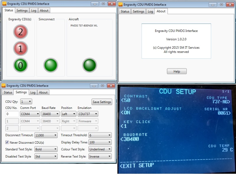

I am attaching two files (cdu log.txt and MLK_CDU.jpg ) for further clarification.

Once all baud rate values were set to the same value CDU seems to respond normally through whole flight. :-)

Those settings are correct. Are you running the latest Firmware in your CDU?
Can you give me a screen dump of the Settings tab.
In one of my first messages I attached several screenshots on which my settings are shown (see above).
Gr, Mladen.
