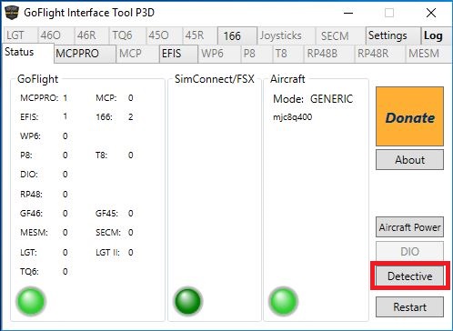

1) Load up your sim and GIT, select the aircraft you are going to import the profile to.
2) In the GIT window, select the "Status" tab, then click on the detective button.

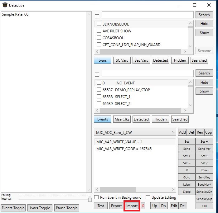

3) The detective window opens, then click the import button.

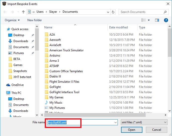

4) Select the bespoke events file from the location you unzipped it to. It will be a .xml file with the name of the aircraft as shown in the first picture of the GIT window above (under the aircraft heading) so in our case it is the mjcq400, so the file we need is mjcq400.xml
