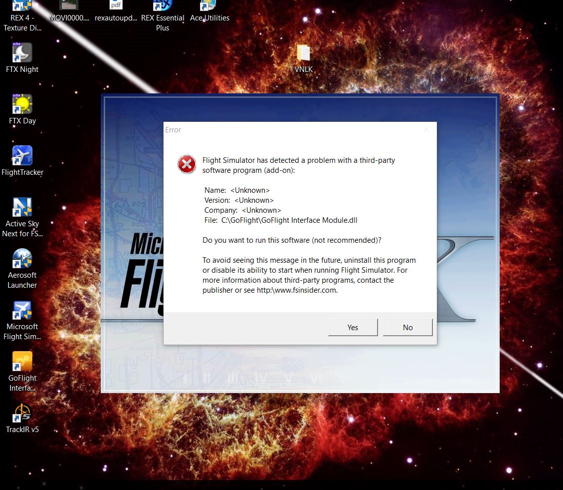

    I have attached what shows up on my screen as I load FSX. When I say yes or no to loading GIT, FSX starts up. If I say yes to loading it then GIT starts and lights are green/yellow/green.
    Don't know where to go next.
    Dave
  • Hi Dave,
    OK, at that point just click Yes and it should be OK.
  • Well, I don't think I even want to know if that's all I had to do in the first place. Sure glad I sent you that screen shot. It said "not recommended" so I don't think I ever tried it.
    One way or the other... problem solved and I'm back in business.
    Thanks again for the patience and continuing great support.
    Regards
    Dave
  • edited June 2016
    Hi Dave,
    Its my fault for not picking up on it sooner.
    FSX has an error state which causes the registry issue and then a warning state which occurs after its detected you are running a module that caused an error state (which you always say Yes to after correcting the registry).
    I don't understand why this happens; but its so incredibly infrequent I haven't really spent a great deal of time investigating it. I found the solution to the issue because some users of FSUIPC had the same problem of  FSUIPC.DLL causing errors in FSX. Its a weird one for sure!
