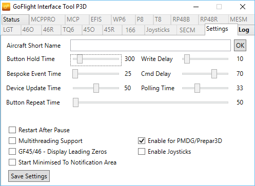

2a) You should choose to install the software where your Goflight drivers have been installed (where GFConfig.exe and GFDev.dll reside). If you choose to install in another directory you will need to start the Goflight Interface Tool, click the Settings tab and select the directory where the Goflight drivers exist.
I tried to keep it cleaner by installing GIT for P3D in a separate directory outside of Goflight drivers.
Now that I have started GIT for P3D, I cannot see any field in the Settings tab that I can set to point to the Goflight drivers directory.
That ability got pulled. All you need to do is copy GFDev.dll from the GoFlight drivers directory into your install directory.
