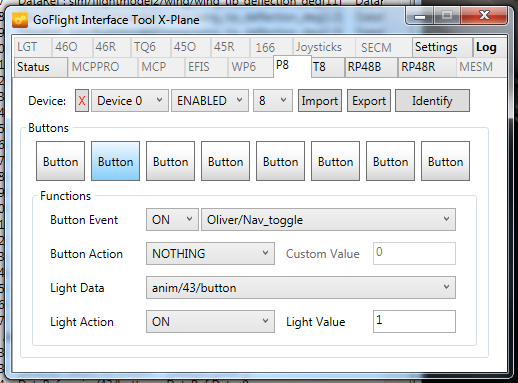

How can I turn on the GoFlight device LEDs? Using the buttons, switches, rotary knobs works fine, Pressing the Identify button in the Interface Software GUI illuminates all 8 LEDs. But how do I get some of them turned on depending on datarefs?
E.g. I set
Light Data = anim/44/button
Light Action = ON
Light Value = 1
Nothing happens when changing the value of anim/44/button (by pressing a goflight device button - the aircraft behaves correctly)

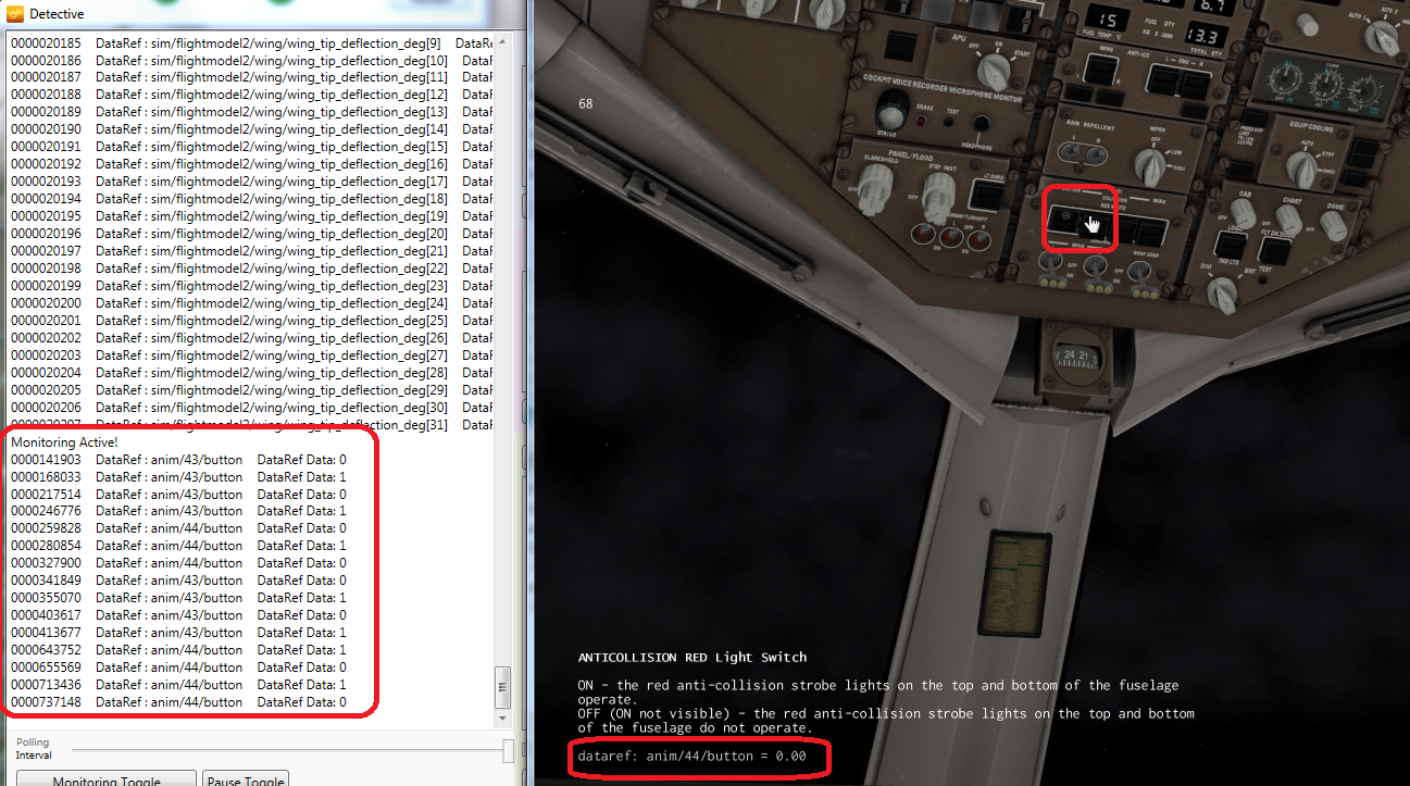

In Detective what values does the anim/44/button have? Also make sure this dataref is not resetting e.g only briefly goes to one and then back to zero.

Can you show me the tasks in Oliver/Nav_toggle assuming its a Bespoke Event.
Also what aircraft is it?
Sure,
it's the 767 from FlightFactor / StepToSky, latest version (1.1.20)
Oliver/Nav_toggle >>>
If anim/43/button = 1 Next Else Next Skip
Goto Next
anim/43/button = 1
Goto Done
:Next
anim/43/button = 0
:Done

That all looks OK assuming nothing has been assigned to the OFF event. Can you try ON_GREATER_THAN and a value of 0.
no - nothing assigned to the off event (I just tested changing from on to off (nothing assigned to on anymore) - didn't help)
ON_GREATER_THAN didn't help, tested this a thousand times.

That's strange. I have the FF777 so I will run some tests to determine what the issue is.
Ok, I have ran some quick tests.
I saw that most switches on the overhead when you set them, immediately reset back - the code/logic of the aircraft over-rules the state change.
Some switches set multiple Datarefs whilst some reset back, others do not and work as expected - its a case of trying all the Datarefs that change to hopefully get one to work.
So my initial thought is that the Dataref is changing back to zero thus the light never comes on.
I'll do some more testing tomorrow.
Following your idea, I did the following:
new bespoke Event Oliver/test >>>
If Bespoke Var 1 = 1 Next Else Next Skip
Goto Next
Bespoke Var 1 = 1
Goto Done
:Next
Bespoke Var 1 = 0
:Done
I connected a button Event (on) to Oliver/test and the light data to Bespoke Var 1 (Action on, Value 1)
thus, the test is unrelated to the aircraft (I do not use the bespoke var).
Observation -> The LEDs do still not work (again: pressing "Identify" illuminates the eight LEDs)
