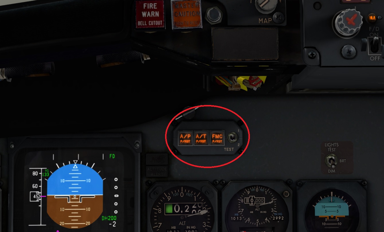

I am looking for some hours for the light data of the IXEG indicated in the picture the assignment for my wp6.
Can someone help?

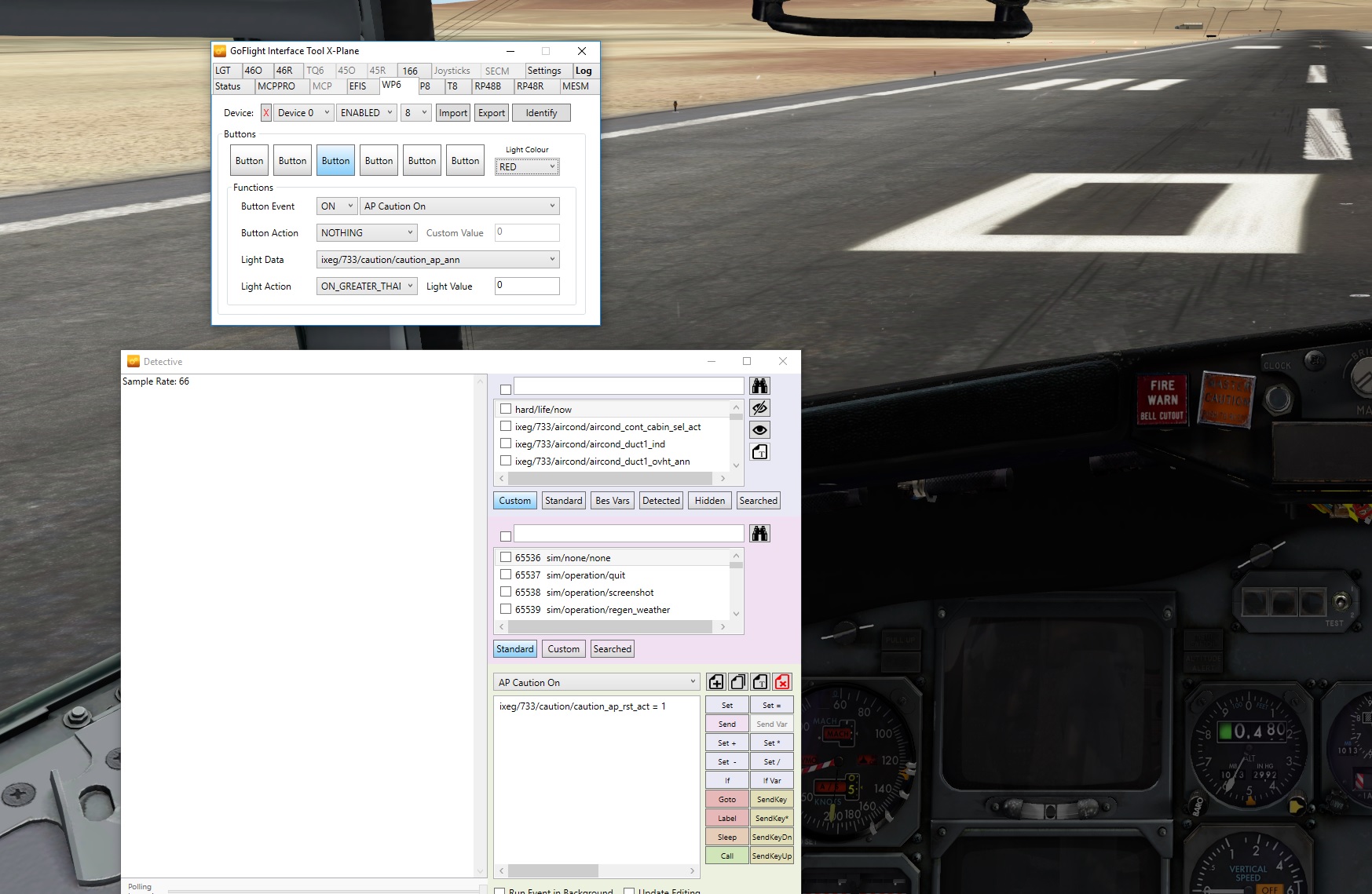

  • Sure let me take a look
    Steve McNitt
  • ixeg/733/caution/caution_ap_rst_act
    ixeg/733/caution/caution_at_rst_act
    ixeg/733/caution/caution_fmc_rst_act

    The button I had assigned correctly. When I press the wp6 button, the warning light in the cockpit goes out.
    My problem is:
    What is the command for the light data in GIT? When the AP-RST cockpit caution light is on, the wp6 light is not on :-(
    Thank you for your time...
  • edited January 2017
    ixeg/733/caution/caution_ap_ann
    ixeg/733/caution/caution_at_ann
    ixeg/733/caution/caution_fmc_ann
    Those are the datarefs for the lights but they don't change from zero
    I'm mystified at why they don't work but I only tried in test mode so the actual fault MAY make them go on using those datarefs
    IXEG always use _ann on the end for annunciator lights
    from what I can see on other annunciators 0.620599 is on at full brightness and 0.310299 is half brightness
    Steve McNitt
    Thanks Steve!
    So my settings were correct, only the luminosity comes only half strongly and is therefore not shown on the led.
    Pity, but we can do nothing,,,
  • I think they are not implemented or broken, hard to say
    Steve McNitt
