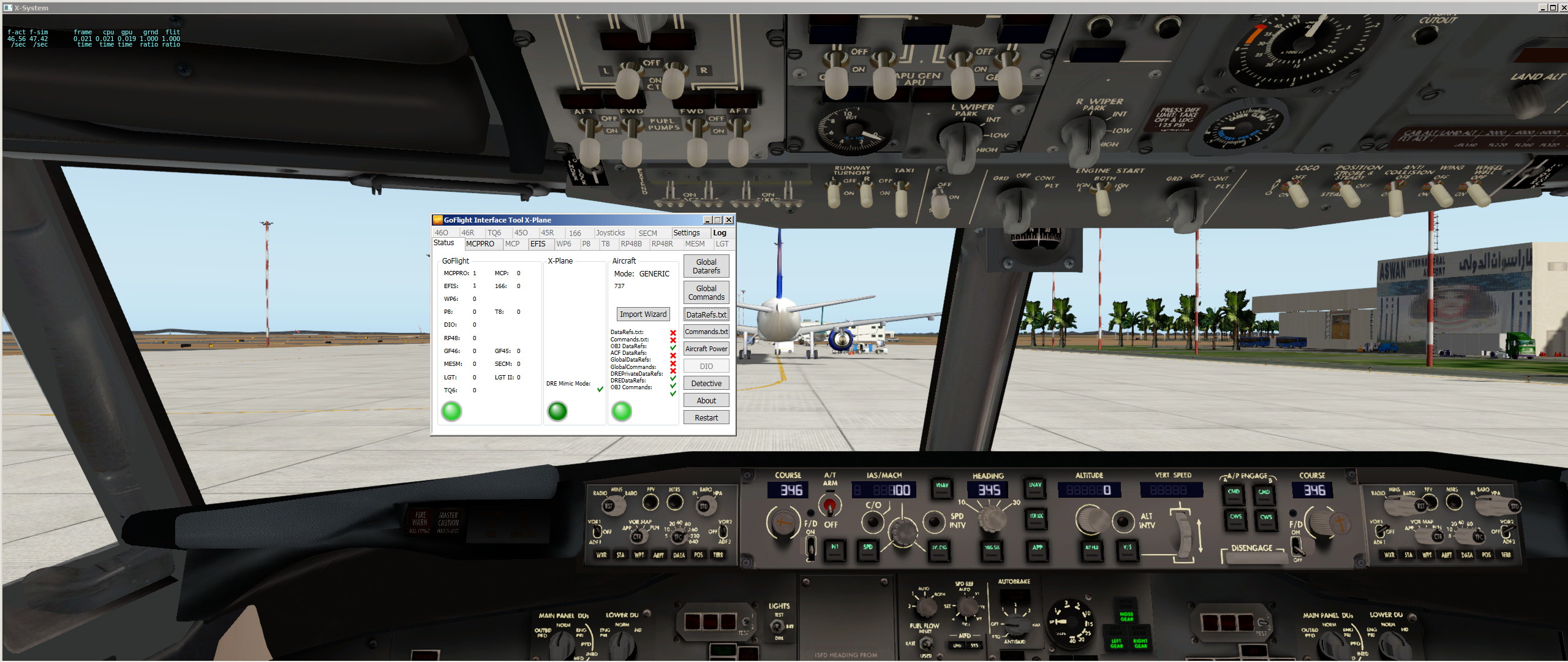

I'm flipping between x-plane 10 and 11 at the moment and today GIT has stopped functioning. The utility launches and the MCPPro starts but with all zeros, it doesn't respond to the controls. I have partial functionality with the EFIS. I have tried reinstalling the program v1.8.0 and even going back to 1.7.2 but nothing changes. I think something may have become corrupted that is not getting replaced with a reinstall, is that possible. I can't think why it has stopped working. I have a screenshot, it looks to me like there are a lot more red X's than before though I can't be sure. I have loaded and reloaded the x737 config without success.
