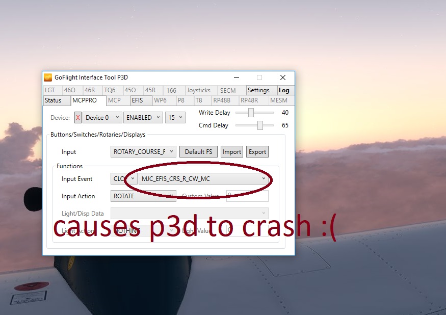

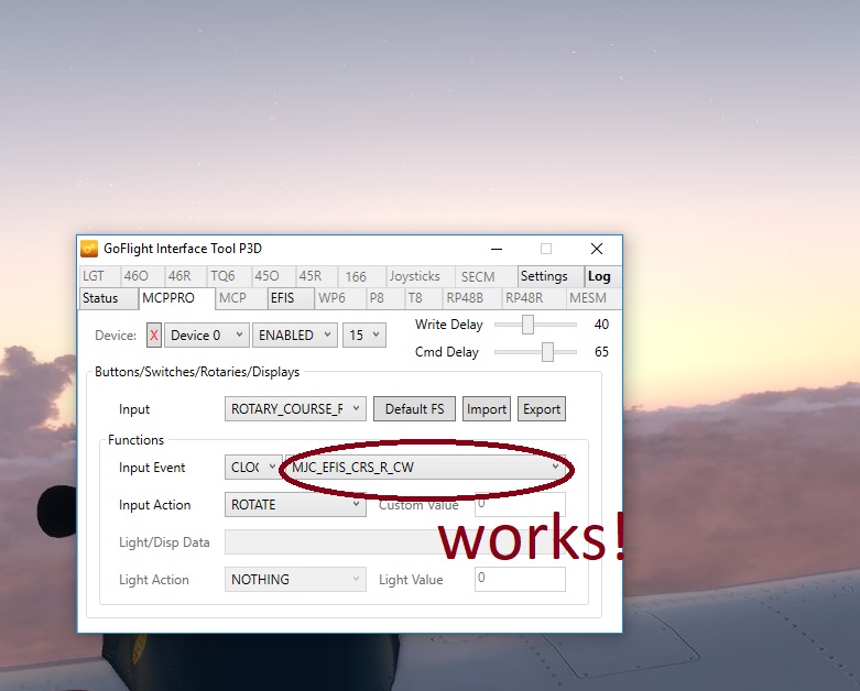

    Great, I'm making some progress! I can get the profile to work (including the faulty mcp rotaries) after some adjustments. It seems that some of the inputs in the q400 are faulty on my end. I can get everything to work with what I believe are the slower rate adjustments, but the faster rate(??) adjustments are causing my crashes. Can anyone confirm that is what "MJC_EFIS_CRS_R_CW_MC" is used for? So for now I'm forced to make course and heading adjustments at the slow rate, which is quite tedious, but at least it's working!

    the _MC on the end is my shorthand for "mouse click". I used some mouse click events as it was the only method I found that would work with acceleration of the rotaries. possibly try tinkering with your sending rates etc in GIT and see what happens. or if you have touched those sliders revert them back to the defaults.
    Steve McNitt
  • I put out an updated profile please see the new post in the user provided BE forum.
