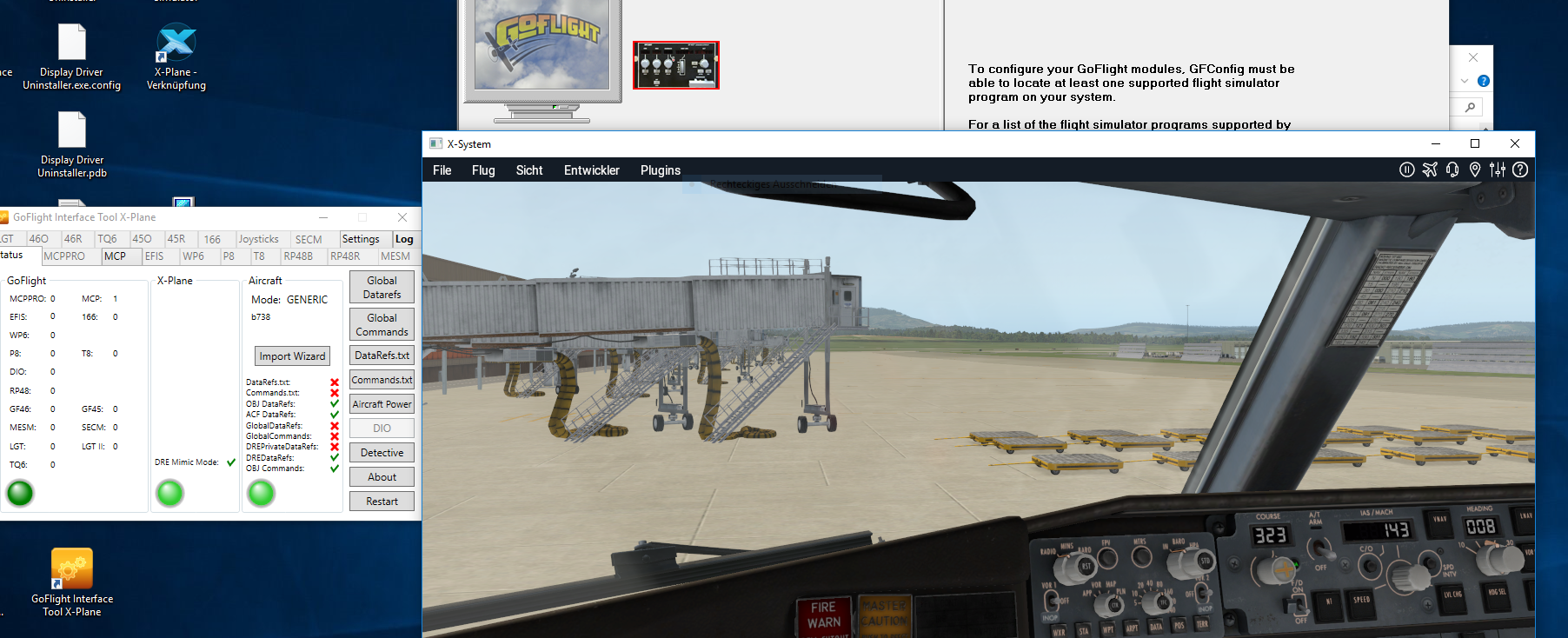

  • Hi Steve
    It's me again. I am still trying to get my GF modules running with the GF Interface Tool. I have done everything you proposed wih no luck. Attached is a screenshot showing what your programme shows on the stat tab. Maybe you can see anything. The GF config tool recognises the MCP modul. Also the GF interface tool recognises the GF modul. However nothing works when I push a button or dial a pot on the modul.
    Regards,
    Thomas

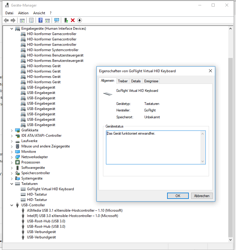

  • I do not know which is the GF device. I attached a picture with the open where it says GoFlight virtual HID keboard. There I cannot change any power management as you can see. This tab is missing. There are others above: some HID konform and some USB Eingabegeräte. The HID konform have a power managment tab but the option is not clickable and with the USB Eingabegeräte the options are checked an clickable.
    Regards,
    Thomas
  • It will be a HID compliant device. If you look at the Windows8Fixer.log you will see the hardware ID of the devices found such as VID_09F3&PID_0064. You can match this to the hardware ID in the Details tab of the driver to find your MCP.
