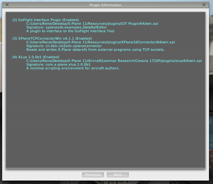

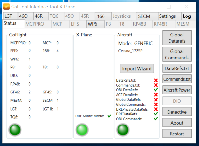

If you would look into the issues that I have in getting the GoFlight instrumentation to work with X-Plane via the GIT it would be very much appreciated.
Attached is a PDF document outlining the system hardware, software GoFlight modules and the simulator power up and results.

    Are you saying that it all worked in 1.8 and the upgrade has caused it to break. If not, have you enabled and configured the devices? It is just the LED's/displays not working or do the buttons and rotaries work OK?

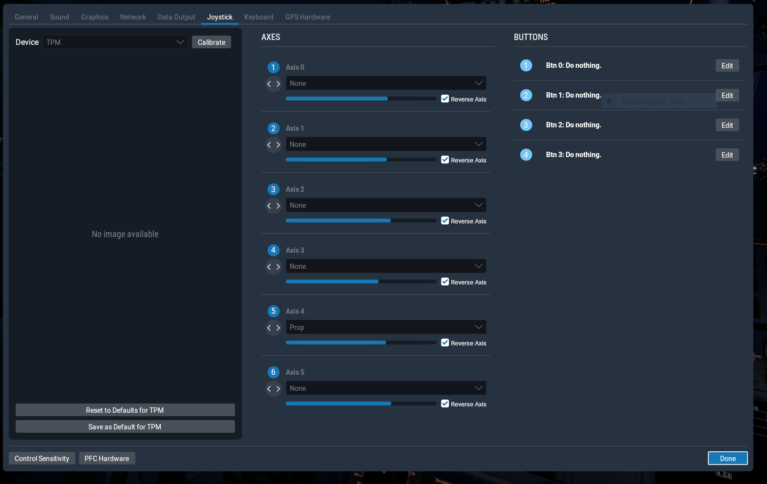

    The is no joystick and thus no TPM support in GIT for X-Plane, although it is planned for the future. The GF-ATC is not supported in any version of GIT as the GoFlight SDK has not opened it up to access.
