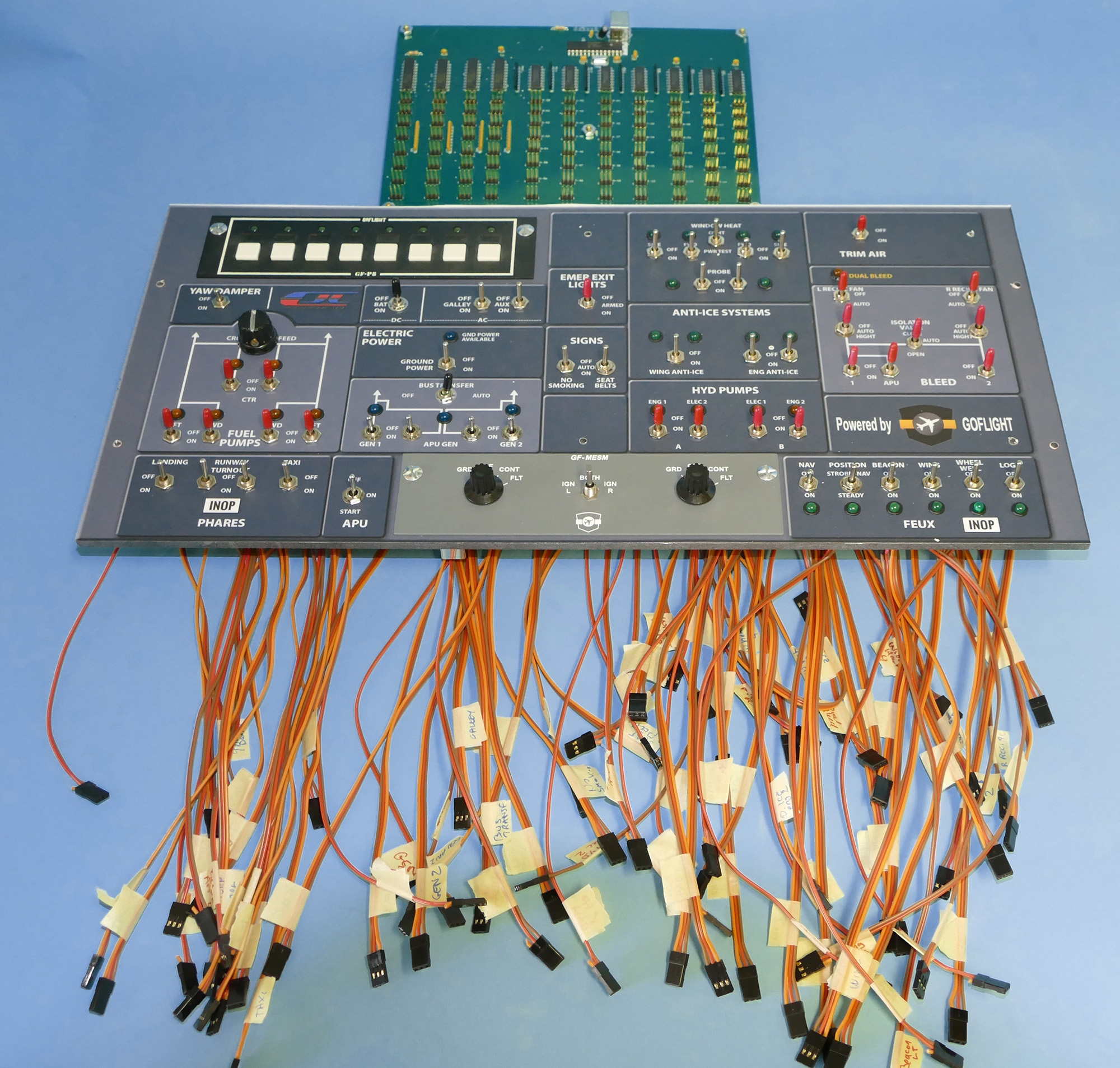

  • Sounds good ! I built my own "simple" overhead using a GF-DIO, and if I have no problem to use all the switches, I really don't know how to do to make work the LEDs. I can get values of the specific iFLY 737 offests from FSUIPC via IFLYTOFSUIPC, but then, I don't understand how I can use these offsets values. A short tutorial with on or two samples would be really useful.

  • New version of GIT available that has built in SDK support for the iFly 737 and 747.
  • FANTASTIC ! I just make some tests to program LEDs of my overhead panel from the GF-DIO with the new iFLY 737 support and it works fine ! I just have to find the correct function, but then it is now so easy ! Thank you so much for this new version ! Now, I have all what I need !
