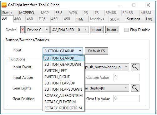

Dave, the Drop down menu has the gear off position already.
I'm using the wrong terminology. I shouldn't have said event, it should be Input. I've attached a screenshot of the dropdown for the Input fields on the LGT tab. This is something that I should raise in the Product Suggestions thread.

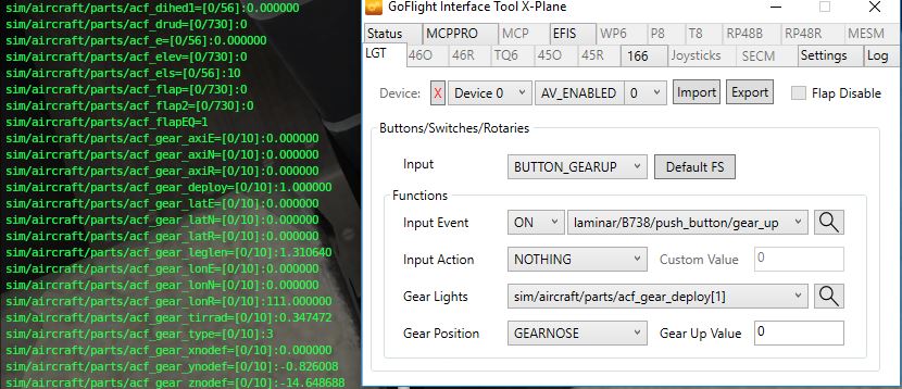

The gear lever works as expected. The gear lights are not functioning correctly. (I've attached the exported XML file for the GF-LGT II).
I use the /sim/aircraft/parts/acf_gear_deploy[0] for GEARLEFT, [1] for GEARNOSE and [2] for GEARRIGHT. These are the standard Default FS settings. As far as I can tell, Zibo hasn't exposed any new datarefs to replace these.
After I start 'Cold & Dark' I turn the battery on to bring everything to life. The gear lights either illuminate in red or nothing at all. X-Plane shows 3 green. I've also attach the LGT tab and DatarefEditor displaying the acf_gear_deploy[0] value (which is 1.000000).
Let me know anything else you'd like me to provide.
