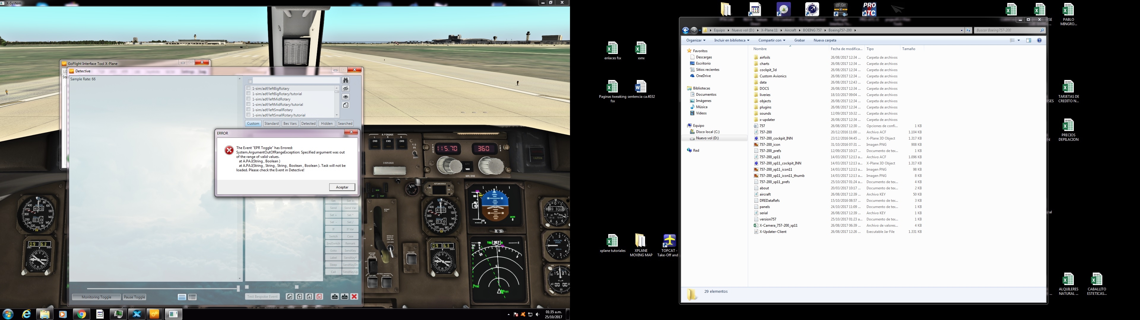

  • WHAT AM I DOING WRONG?
    1.jpg 759.7K
  • Wipe the settings from the EFIS (red X). In Detective, clear out all Bespoke Events (Big Red X in bottom right corner). Remove any files in the aircrafts root directory called DREDatarefs.txt, Command.txt, Dataref.txt.
    Make sure you have the very latest version of GIT (uploaded a couple of days ago) and then run the import wizard.
