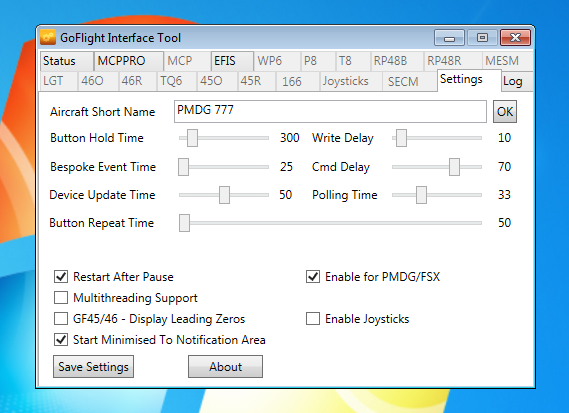

The PMDG SDK is quirky so please read the FAQ entry called "My MCP PRO or MCP Advanced is not updating its display (just showing zeroes)" here: https://www.pollypotsoftware.org.uk/support/user-guide/user-guide-git/41-faq/70-faq.html

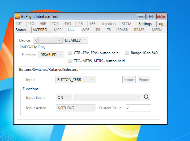

Also, make sure you have enabled the Goflight devices in GIT for each of the aircraft.

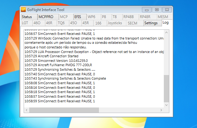

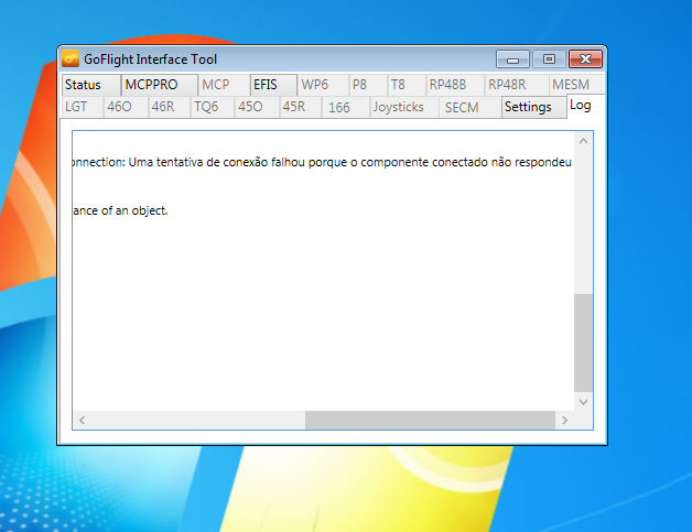

If that doesn't help, let me know what flight sim and version of GIT you are running and also copy and paste the GIT log from the Log tab with either the 747 or 777 loaded.

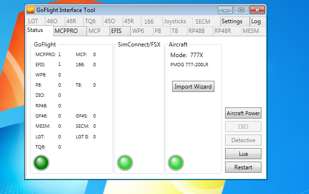

When the 777 or 747 are loaded with the virtual cockpit showing, does the 3rd green LED on the status tab flash?
