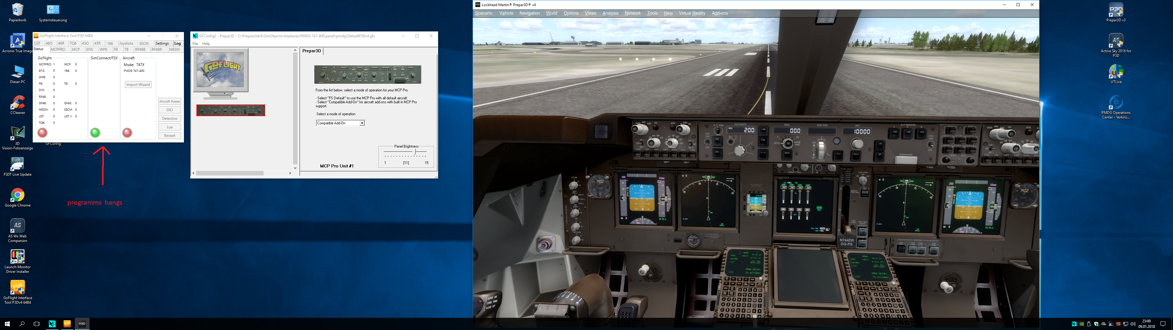

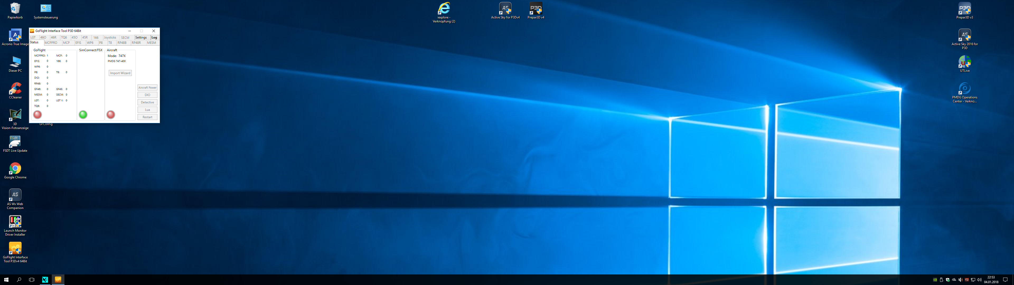

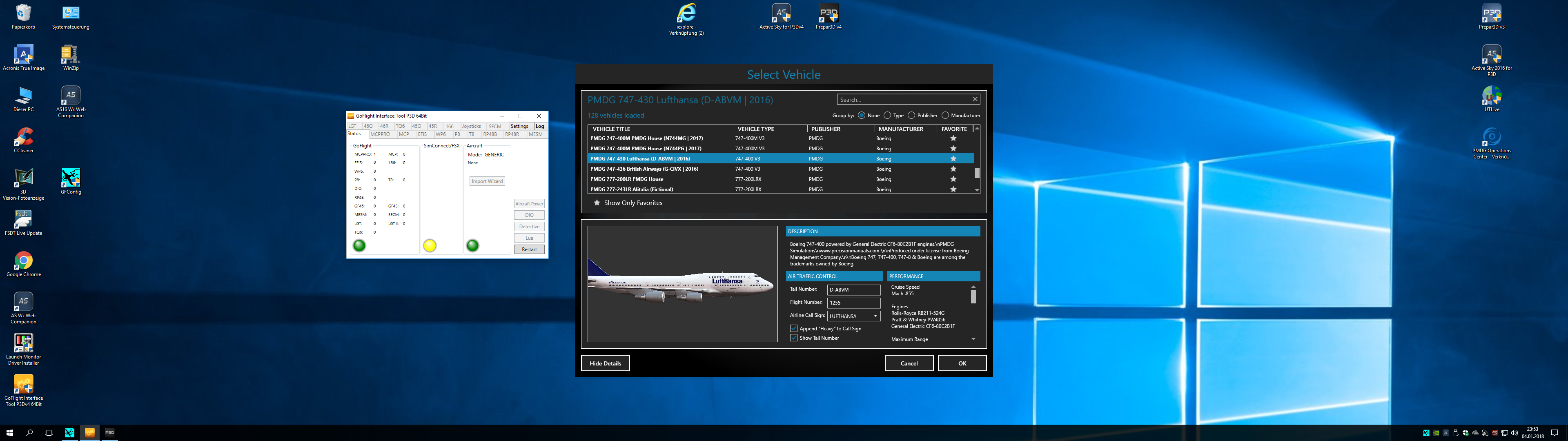

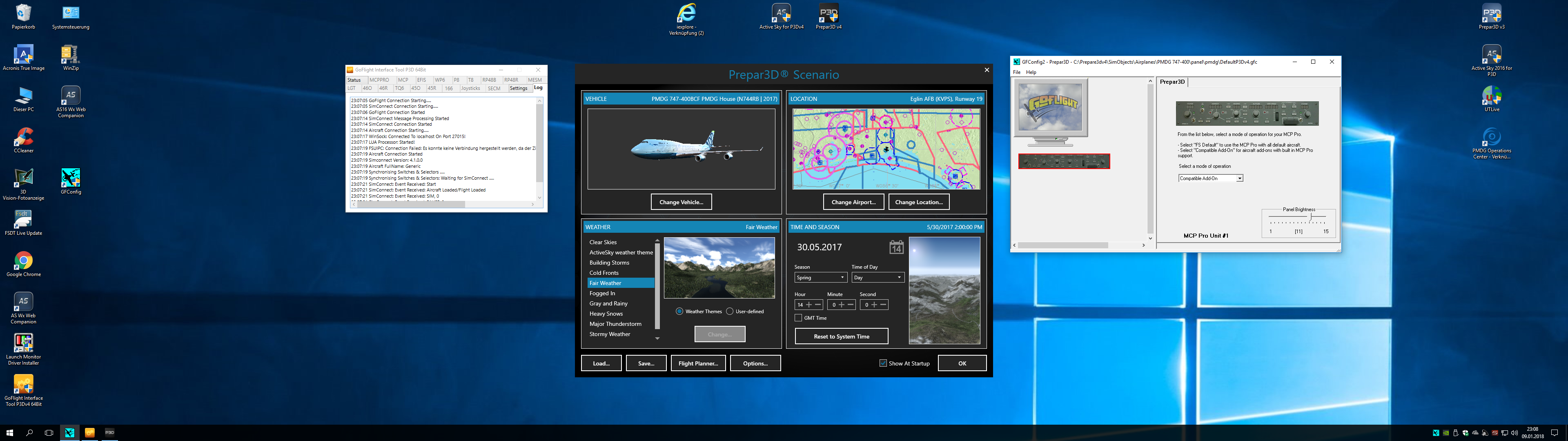

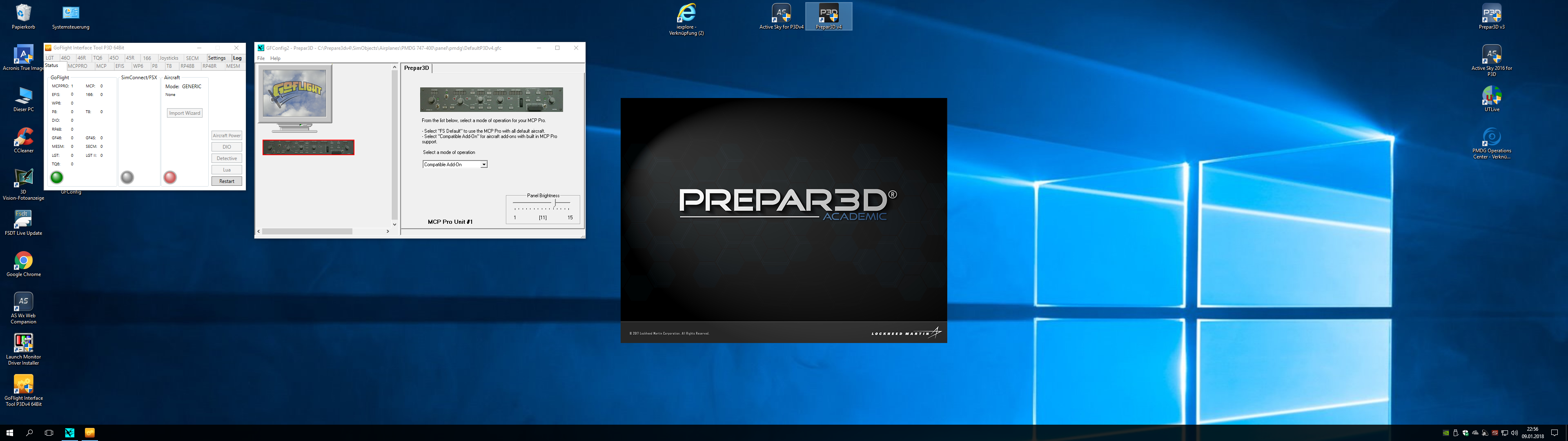

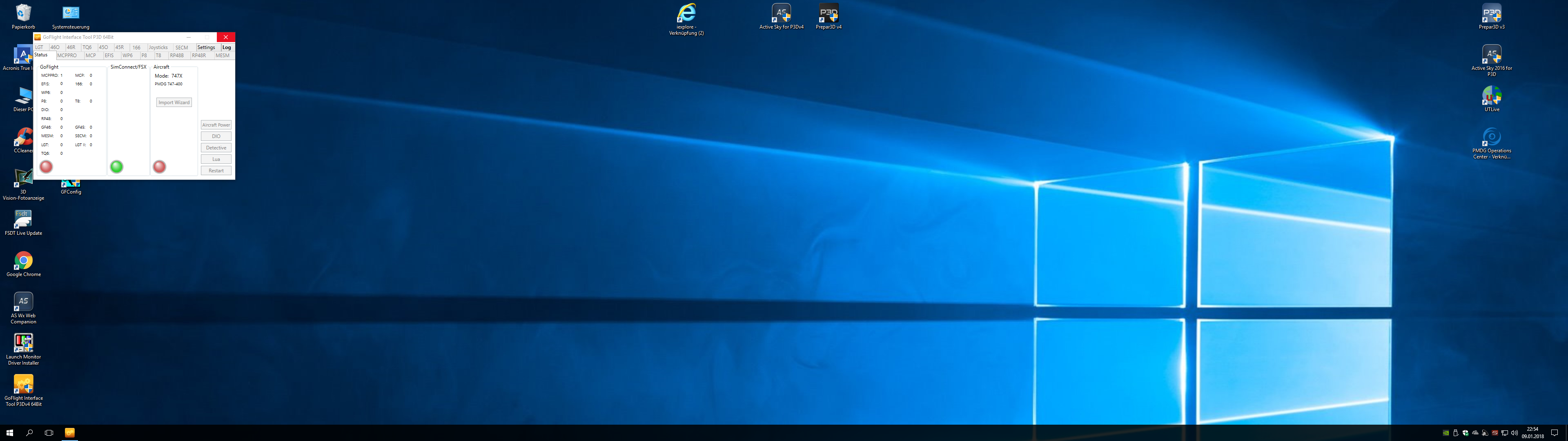

  • hello steve
    i have load the newest 747
    no change, after closing the sim, the Interface Programm hangs!! see the attach file
    best wishes
    bottiimageimageimageimage
  • The 64Bit version of GIT is in BETA, so it may be a bug. Have you tried the 32bit version of GIT with P3Dv4?
  • no,
    ok i will trie.
    ( but way 737/777 no Problem?
  • it is NOT running 32bit version , and always hangs ( hangs only pmdg 747)
