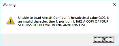

Unable to load Aircraft Configs
Hi
Im suddenly getting the attached error as soon as I open Go Flight Interface tool for X Plane 11. I have downloaded the latest version: -
GoFlightInterfaceTool_SetupX-Plane_2_0_13_0.exe
Any help would be appreciated
  • It looks like your settings files are corrupt. There should be a last known good backup in Documents\GoFlight Interface Tool\Backup which you will need to copy and rename.
    If that doesn't work, use your own last backup of the files.
  • Thanks. Ill try when I get home. Should have mentioned that I had done a complete reinstall but was still getting the above message. Do you reckon the backup will resolve this issue then or perhaps an underlying problem elsewhere?
    Which leads me ask, other than an uninstall, is there anything else I should do to completely remove everything associated with GIT?
  • Hi
    Of the 3 files. Have I to copy the SettingsXPlane.xml.bak file?
    And where do I place this and rename it to?
  • Go it...rename the folder! faceplant! Many Thanks up and running
