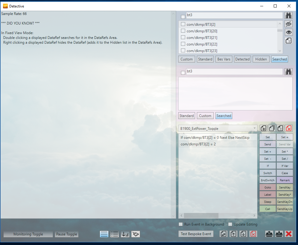

I thought I would create some controls for the B1900 However when I start GIT the Log file Shows every thig is working correctly.
I can Identify Panels etc. When I start the detective The log file fills with "Unable to monitor Dataref" Unexpected Reply Message 20002
Any Ideas ?? I can change the dataref n DRE No problems so its not a read only error with the data ref

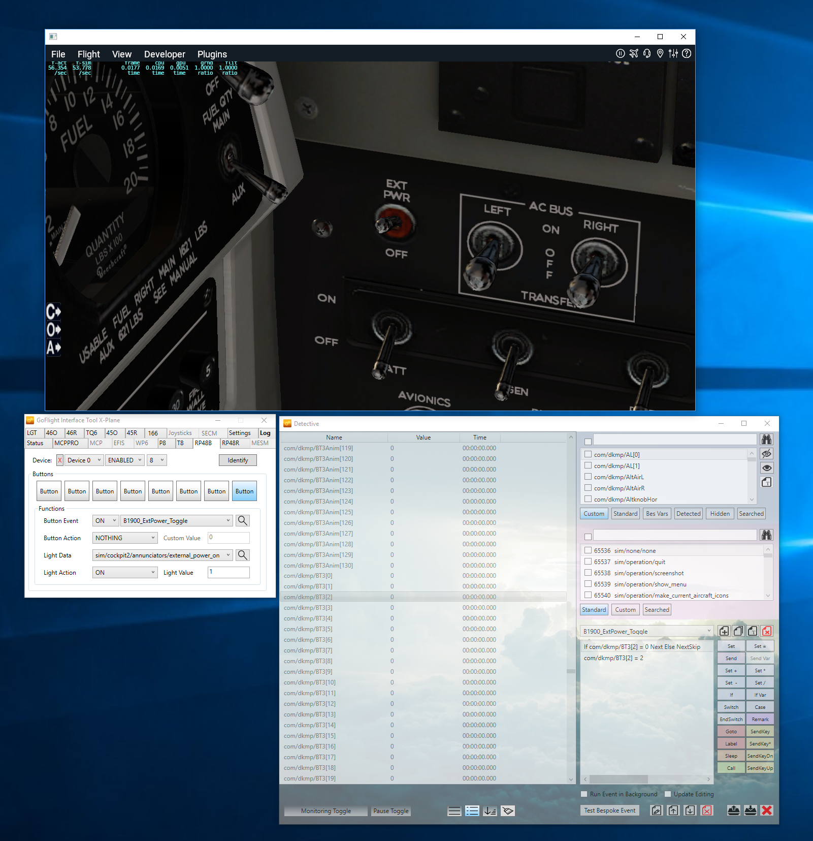

as previously mentioned I have edited the value in DRE and it works fine I have also used Other software to edit the value and it works fine

i have also swapped to the Flight Factor 757 which has lots of Bespoke events created (11 goflight panels) and the only error I get are ones where the you correctly point out the datarefs contain text.
So now Im confused as to why Flight factor works Ok but the default 172 has errors

13:51:03 GIP: Send Message - Unexpected Reply Messsage - 20002
13:51:03 GIP: Unable to Monitor DataRef com/dkmp/BT3[2] - 20002
Along with what I attached earlier

Sorry for the late reply. I did look into this and basically the GIT plugin calls an X-Plane routine to find the Dataref to make sure its valid and then enable the monitoring process. These datarefs are not being found so its impossible for GIT to monitor them as it cannot pull a reference to the Dataref. I'm guessing DRE does not do the check and pushes them out regardless.
PS: The Data Ref Tool does the same as GIT and they won't show as they are deemed invalid.
