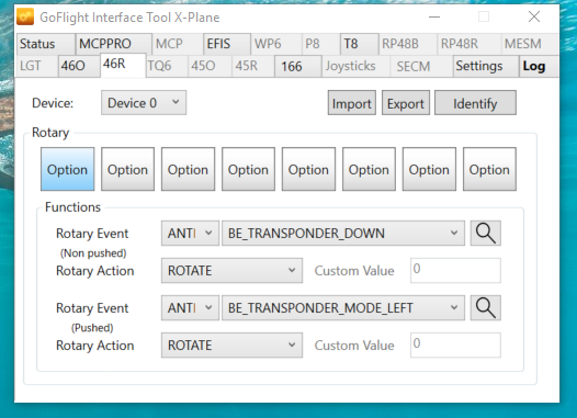

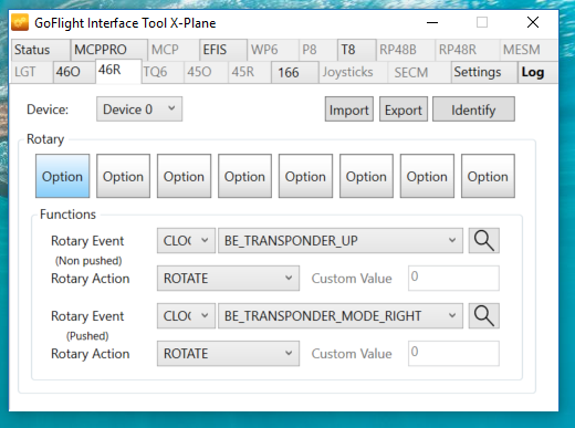

7. In GIT, on the 46R tab, click the 1st "Option" button under the "Rotary" section. This needs to be the same "Option", as you selected on the 46O tab. In other words if you selected the 1st option on 46O you need to select the 1st option on 46R. Under the "Functions" sub-section you are going to have to select a rotary event, both clockwise and counter-clockwise, for the "Non-pushed" and "Pushed" rotary actions. This is where I spent the bulk of my time. You're going to need to discover what actions in the simulator cause each of the 4 numbers of the transponder to increase/decrease.

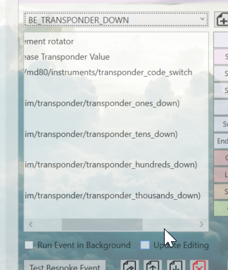

For step 7 above you're likely going to need to download the "DataRef plug-in" to X-Plane. It'll be a great tool, in combination with the GIT Detective, so figure out what variables (DataRefs) are affected by mouse clicks, etc. in the simulator. Don't get frustrated as it'll take a bit of time to figure out how one variable changing can affect others. In some cases I realized that I had to simulate "Sending" a message to the simulator whereas in other cases I only had to change the value of a variable (DataRef). I'm assuming this will be a similar scenario for most aircraft. Regardless, you can make selections, click parts of the cockpit, etc. and see those changes reflect on DataRefs listed in the plug-in dialog. Those DataRef names in the plug-in exactly match the same variables in the GIT Detective.

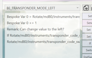

Here are screenshots of selections and the options I used for my BESPOKE events.
46R tab options

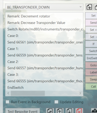

Up/Down transponder numbers

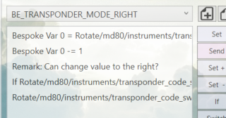

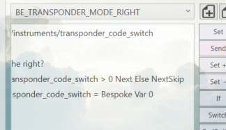

Left/Right transponder modes

    In the middle right of the GIT Detective you can view and search on events. Although you can likely do more than just send the event to X-Plane I've only used these events to specifically do that. If I'm building a custom BESPOKE event and want to send the message that a user flipped a switch in the cockpit there is potentially an event associated with that action. In that case I'm going to find that event, highlight it and click the "Send" button in the BESPOKE designer (bottom right of the GIT Detective dialog). I've combined "Send" events and variable (DataRef) value changes within one BESPOKE event to accomplish several things at the same. I.e. turning on landing lights, panel lights and the beacon light all at the same time.

  • Here's my latest that seems to place nicely again.
    Chris - GoFlight and X-Plane 11.
