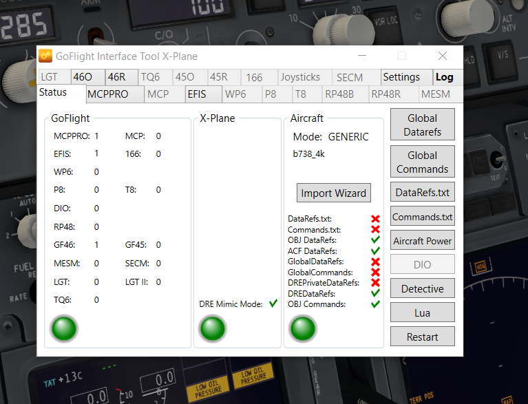

When I am using either Latest Zibo, FF 757 OR 767, Saab A340 The MCP lights up showing the correct numbers on the sim but I cant change anything from The MCP Or Efis
I can spin the dials within in the simulator and the displays change but this is now quite useless
I can see on the status page that there are more red Crosses than usual so something is not right
Also when I come to use the import wizard I cannot select the EFIS

I have atatched the log file of GO Flight and an image of my status page

  • That's very odd. Can you check in the MCP PRO tab for any of the rotaries that there are Commands present because the Datarefs are clearly present as they are lighting up the displays.

  • There is no device selected in the drop down!

  • OK it looks like VNAV is a Bespoke Event. Can you go into Detective, select VNAV in the bottom right drop down and do a screen dump.
    Not sure why but all is now working
    I have not altered anything but its all good on various air frames
