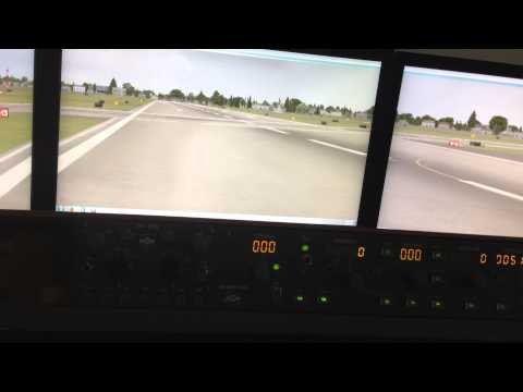

    yes, i did deleted all files locasted in my documents
    like i told you i re install all again .
    what i did was  uninstall the 2.24 version of GF, Config reboot then install the 2.23
    delete all pdmg737 tool interface clean all in my computer Reboot, and then install the version2.23.
    WORKS vERY WELL WITH 737-800 deafult aircraft fsx AND ifly 737-800 but VERT SPEED DONT WORK LIGHT REMAIN OFF SAME WITH IFLY 737.
    dont work at all with the 737-800 pdmg stil having the same problems as before.
    course 000 same pdmg
    ias-mach mcp light off fsx 110
    heading 258 cmp fsx 100
    altitud mcp 257 fsx 10000
    vert speed mcp 512 fsx light off
