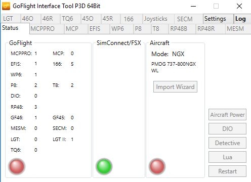

I'm using the GoFlight Interface tool succesfull for some time. But suddenly it freezes upon start-up for no reason (or maybe not obvious to me). I have not made any changes to my system (Windows 10, P3Dv4, GF-config tool, etc.), at least not that I'm aware of. Tried to start the software with P3Dv4 and PMDG B737 since than for several times, but result remains the same.

2.28 is the correct version. I would rename Documents\GoFlight Interface Tool so GIT starts without any config data and see if that works. If not unplug all your GoFlight gear and plug in one item at a time and start GIT. Rinse and repeat until GIT locks up again.

When I select the PMDG 737 aircraft in P3D or load a situation for the PMDG 737 this is when, on 1 out of 5 occasions, GIT will hang displaying the same as the Op's screenshot. I have to terminate the process in windows taskmanager. Unplugging the GoFlight hardware and restarting GIT will result in another hang as soon as the PMDG 737 is selected in P3D, so rebooting is the only option to rectify.

for me it worked out to rename Documents\GoFlight Interface Tool. GIT created a new directory and it works just fine now. I only had to programm again a few buttons and that was it.

GIT always freezes, if the GF modules are changeing the USB #. i.e. one P8 has been programmed as device #0. With the next PC-start, suddenly this particular P8-module becomes #1 and another P8 module becomes #0. In that case GIT freezes. It is recomended to delete the old GIT-directory under 'Documents', GIT will create a new 'empty' folder and you have to re-program the GF-modules.
As it may happen that with the next PC-start the GF-modules will be configured again with the 'old' setup, I don't delete the 'old' GIF-directory but only rename it (i.e. GoFlightInterfacetool_old). Than GIT will also create a new directory and I have to re-start programming my modules.
If I face the same problem again and the order of the GF-modules changes back again to the previous order, I don't have to re-programm again but only re-activate the previous directory to the original name and it will work again. At the same time I re-name the 'not working' directory. That way I can switch between the 2 setups w/o needing to re-programm the GIT again and again whenever my PC changes the # of the GF-modules.
