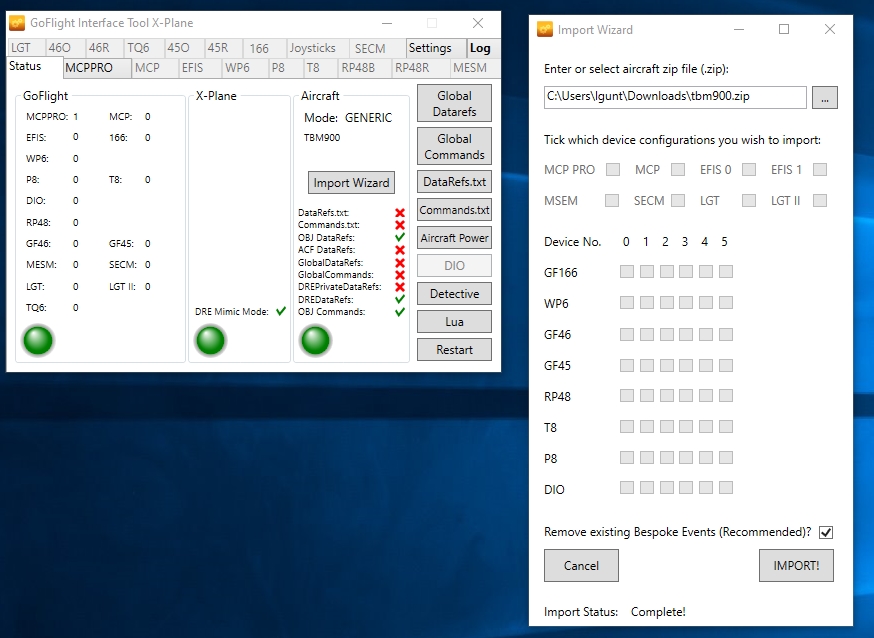

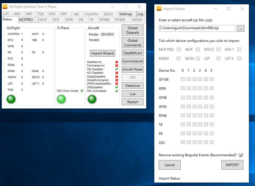

    Restarted X-Plane and then GIT: log-file has no errors. Filled import wizard manually by entering the file and path. I cannot click the MCP Pro box. Click Import. After a while is message: Complete. But nothing changed and the MCP Pro is still dead as it was. See screenshots before and after import action.

  • OK, I have just looked at the download file and the chap who wrote it has made it incompatible with the import wizard. If you unzip the file and then go to the MCP PRO tab and use the import button on there to import the file it should work OK. You may need to quit GIT and restart it to make it function correctly.

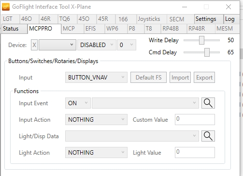

  • Thank you Steve. However it is a pity I cannot import on the MCP PRO tab. Everything is grayed-out (attachment). The same person did write for the a319. There he instructs placing the xml file in the Documents/GIT folder. I tried this for the TBM900. Nothing changes in not being able to import.

  • The combobox to the left of DISABLED needs to be clicked and then select Device 0 and everything will become enabled. Also after the import, make sure you change DISABLED to ENABLED.
  • Steve, thank you for your help! It worked out well I am now testing and experiencing the MCP Pro for multiple aircraft. So far so good. [Sorry for not replying earlier, but my Internet connection was down and only just now restored.]
