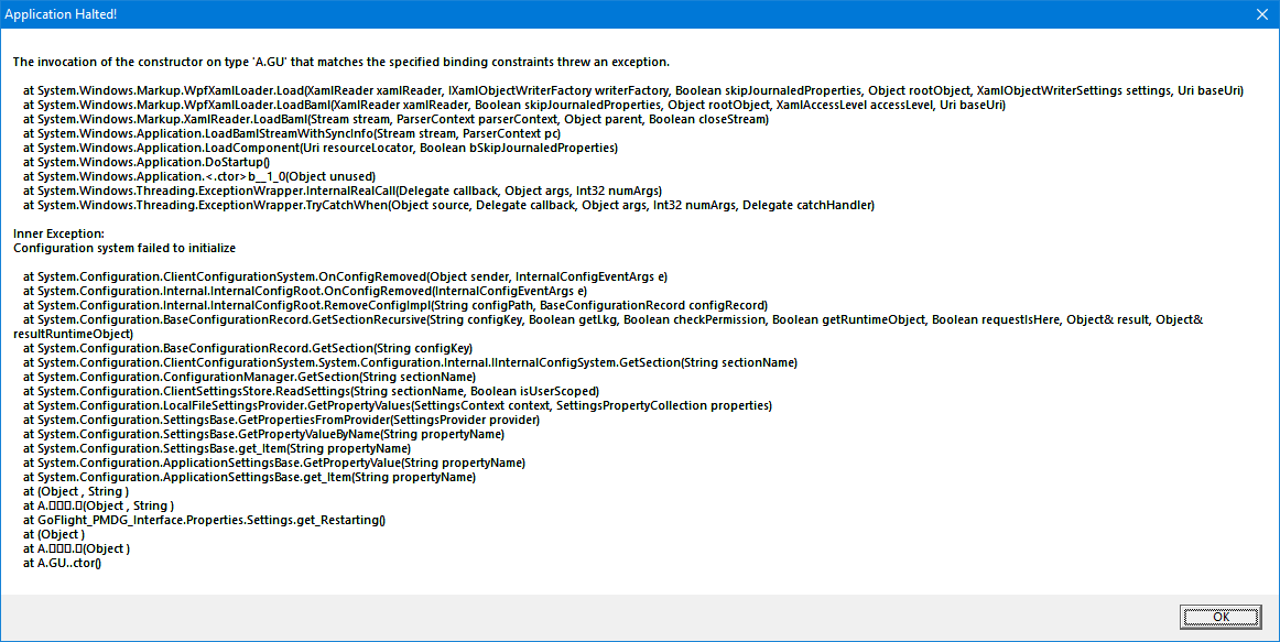

I can no longer open Goflight interface for x-plane. Ive tried downloading the latest software (2.0.16.3) and installing again but im still getting an application halt. Ive attached a screenshot of the error. Any help would be appreciated.

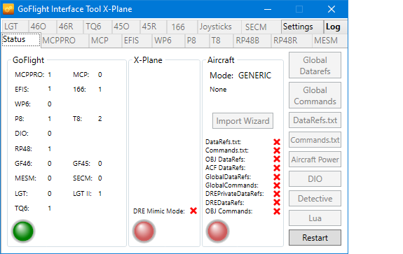

    Update
    After further install attempts I can now open the interface, however Im continually getting the attached Warning. I can now no longer import files as that box is greyed out.
  • Your config files are corrupt (Documents\GoFlight Interface Tool). Restore them from a backup. They are also backed up in Documents\GoFlight Interface Tool\Backup but if you have run GIT more than a few times with this error, they are probably corrupt as well by now.
    If that doesn't work, just delete the directory and GIT will start clean, but you will have to set everything back up again.
  • Thanks Steve. After a few attempts I managed to get myself up and running. I had a backup of my different module settings for each aircraft but unfortunately lost some Bespoke Events which I've had to do again.
