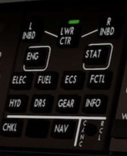

    Great thread, guys. In addition I use buttons for the selections on this part of the panel (can't remember what it's called) to switch screens on the lower EICAS display. Very useful on a flight.
    -Mike
