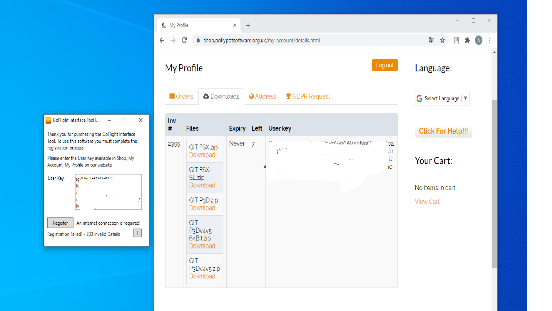

  • My file does not start «GoFlightInterfaceToolP3Dv464Bit_Setup_3_8_0_0» writes Registration Failed – 203 Invalid Details
  • I have reset your install count.
  • Thank you, re-installed it but installed a file that 64 bits does not register!
    In downloads of 5 files, everything steams registration, in addition, 64 bits
  • the number of downloads is not over yet
  • I have just tried your user key and it works OK for me. Make sure you are not using google translate as this corrupts the user key. Your key should start with GM8 and end with YZY=
