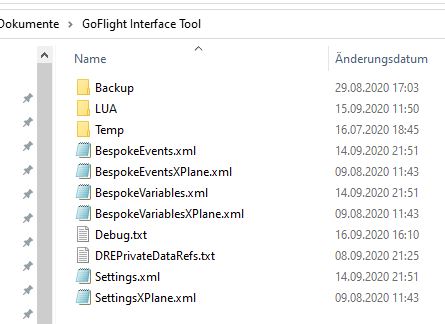

  • Thank you Steve. I only had setup my MCP-Pro, Efis, SECM and LGTII. I start MSFS first, load the flight and then start GIT. Everything is working ok. Only if I quit GIT, this error message appears.
    Should I delete some files in my Documents folder?.

  • And after I deleted all settings (in documents), which I created with the first version of GIT, the new settings I created will not be saved.
    Regards,
    Martin
