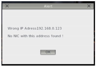

  • If I understood your request, I turned off FW, 2. started XP, 3. started PIT and it connected as before, made sure both MCP and EFIS were "Enabled" NOTE: When XP starts and gets to saved flight screen an error window comes up "Wrong IP address, No NIC with this address found" Thank you for your patience Steve!

  • Hi Jeff,
    I'm guessing you have XPUIPC installed in the plugins directory. The NIC issue is that the IP address in the XPUIPC ini file doesn't match your computer IPv4 address.
    Open up a cmd window and run ipconfig and see what the IPv4 address is. Make sure that address is in the ../X-Plane 11\Resources\plugins\XPUIPC\XPUIPC.ini file as the server address.
    Restart X-Plane.
    See how that goes.
  • Hi David,
    Yes, that took care of the NIC error in XP, thank you so much!.
