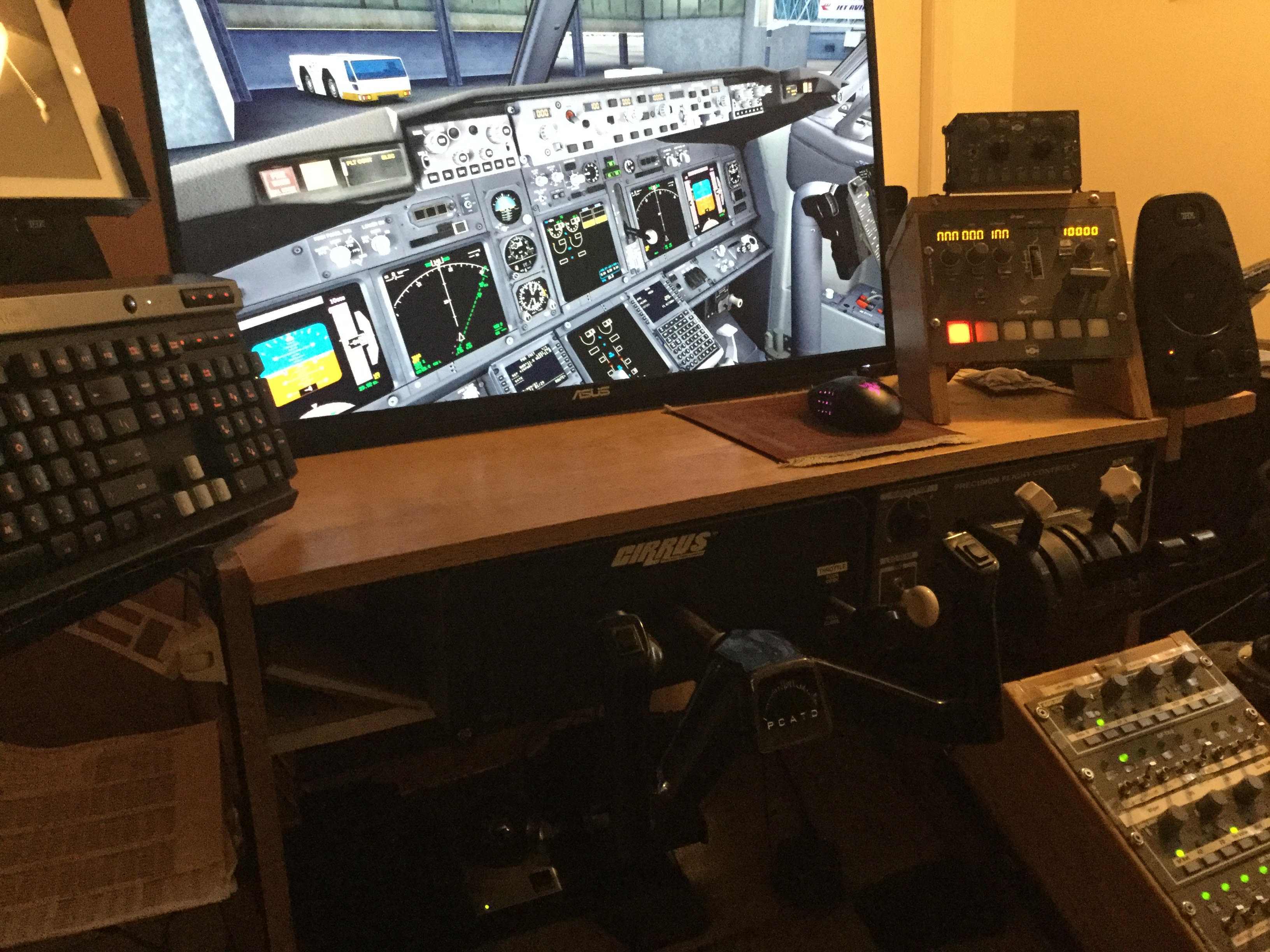

I have the Interface tool and just updated for it to work with the BBJ. My pmdg 737's work so good and I hardly touch the mouse for any thing. My question is, I just bought the dc-6 and there's certain actions such as the 'Gyro pilot' and 'altitude cruise' flip switch that you have to look way down and in the dark you can't find it 1/2 the time, and the cockpit lights when you fly at night none of my go flight buttons or switches work except for the park brake and I have about 10 modules At night I have to set dusk -dawn or daylight, go in turn the lights on that i need and then put it all back to real night time, there has to be a better way . I'm ready to buy a toggle switch Go-Flight module just for the dc -6 if I knew there was a way to program them. I see in the down load section there are Aircraft conf. files for different aircraft but it's way above me head and no way am I taking a chance when I have everything working real nice.

    Ha aren't you getting brave, yes i just updated it so the pmdg BBJ works. I have the Advanced auto pilot that Go -Flight don't make any more and it works not all too shabby. I think I'm fine there Ron . The T8's i have 2 of them and RP 48's i have 2 also . If i can get the Gyro Pilot flip switch and the flip altitude hold to work and a few light so i can see some thing i should be in pretty good shape .
