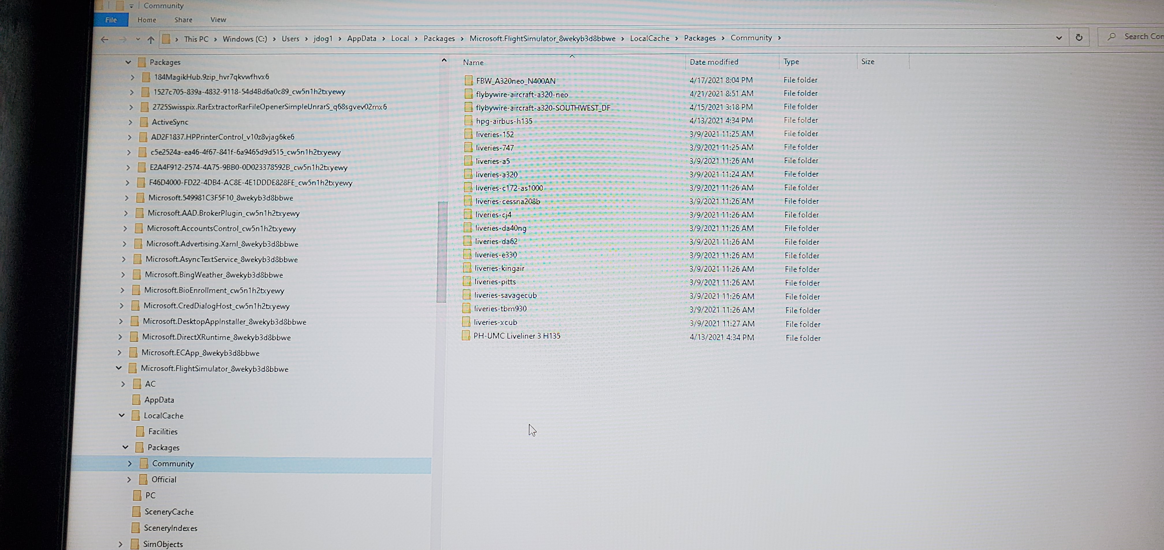

  • OK, had a few reports of this. I suspect the WASM module is not running. Can you check you have a pollypot.... directory in your FS2020 Community folder. If not where is your FS2020 community folder?
  • I do not have pollypot software in my community folder. I do have polly pot loaded.. The only thing in my community folder is liveries
  • OK, It looks like the Community folders are different depending on who supplied the software (God only knows why??!!).
    I have uploaded two versions of GIT for FS2020, one for Steam and the other for MS Store, you need the MS Store version.
  • I have bought MSFS at the MS Store but installed it on another HD. If I install the store version I have to put the "pollypotsoftware-flightsimio-module" in my Community folder. This way GIT works. It's a little misleading, as there is no readme that the module must be downloaded and copied to the Community folder.
