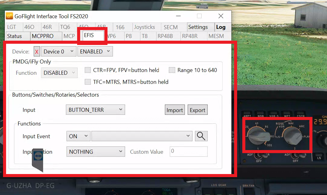

  • Not all functions of the FBW A320 have Lvars associated with controls since its still a work in process. What buttons are you wanting to use?

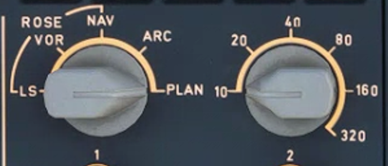

  • Only these two buttons
    In the attached picture

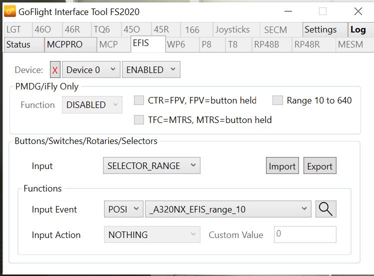

  • awaisi88,
    First, these are knobs and not buttons. They require multiple selections, not simple on-off for buttons, so knobs are more complicated to make work. You have to assign each position on the selector.
    The mode and the range knobs on the EFIS require custom bespoke events for each knob position. There are no direct Lvars from FBW that you can directly assign to a knob position in the GIT. It requires creating separate bespoke events in the Detective and then assigning each event you create to a position (Position 1, Position 2, etc.) on the mode and range EFIS knobs.

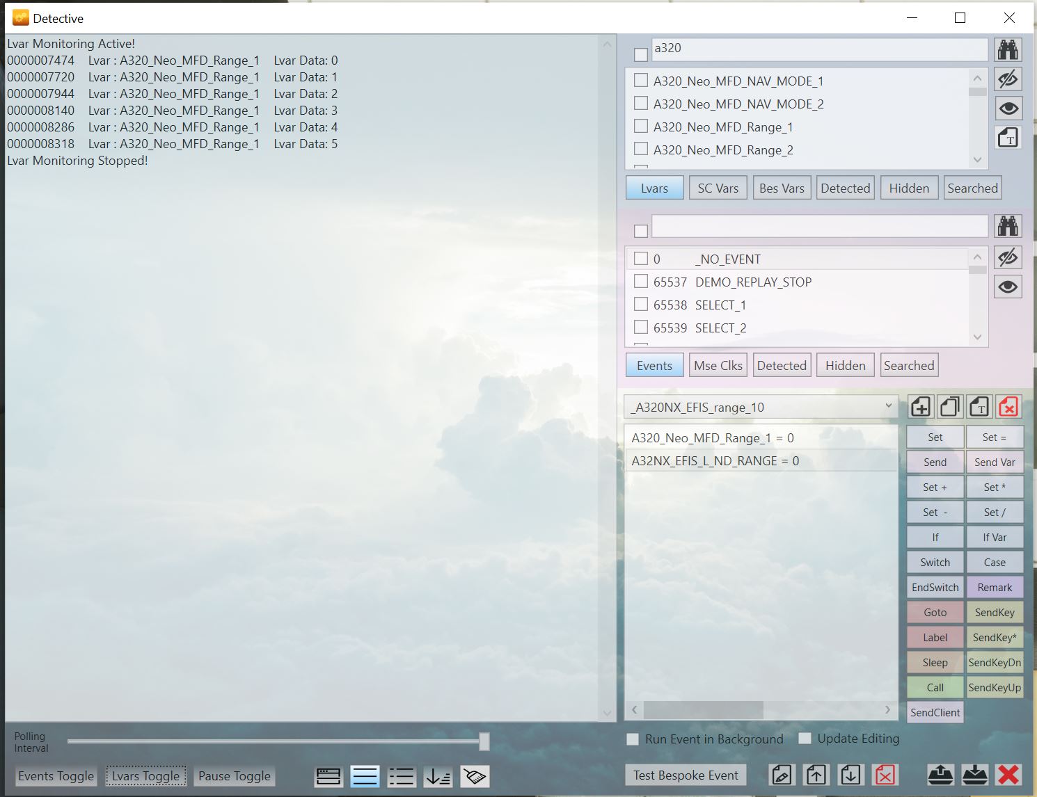

    For the Range Selector, create in Detective:
    1. an event “A32NX_EFIS_Range_10” and search for and assign “A320_Neo_MFD_Range_1=0”
    2. an event “A32NX_EFIS_Range_20” and search for and assign “A320_Neo_MFD_Range_1=1”
    3. an event “A32NX_EFIS_Range_40” and search for and assign “A320_Neo_MFD_Range_1=2”
    4. an event “A32NX_EFIS_Range_80” and search for and assign “A320_Neo_MFD_Range_1=3”
    5. an event “A32NX_EFIS_Range_160” and search for and assign “A320_Neo_MFD_Range_1=4”
    6. an event “A32NX_EFIS_Range_320” and search for and assign “A320_Neo_MFD_Range_1=5”
    For the Mode Selector, create in Detective:
    1. an event “A32NX_EFIS_mode_plan” and search for and assign “A320_Neo_NAV_MODE_1=4”
    2. an event “A32NX_EFIS_mode_arc” and search for and assign “A320_Neo_NAV_MODE_1=3”
    3. an event “A32NX_EFIS_mode_vor” and search for and assign “A320_Neo_NAV_MODE_1=1”
    4. an event “A32NX_EFIS_mode_ls” and search for and assign “A320_Neo_NAV_MODE_1=0”
    Notes:
    1. This is programmed for the FBW A320 Development version. I have not used it on the Stable or Experimental versions from FBW.
    2. Remember that the EFIS is for a 737, not an A320. There are five positions for mode on an A320 and four mode positions on a 737, so one position on the A320 will not be selectable. You can decide which one to not use.
    Steve G.
