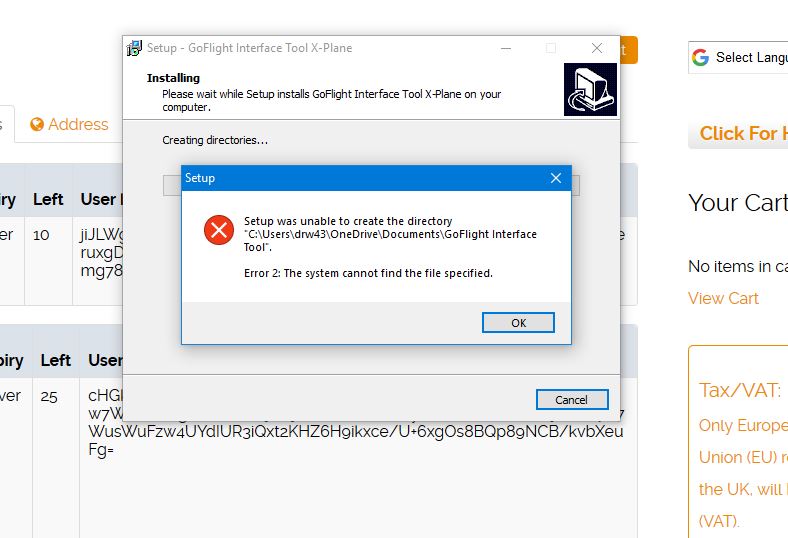

I deleted GIT and the GIT plugin in the plugins folder. Checked manually to ensure everything was removed. I did a registry clean with Ace Utilities.
As has happened before I get the attached error message.
To get around this error message, as I said above, I made the file it was looking for on the "OneDrive" Then it completes the install but then I get the CTD when trying to open Xplane with the log.txt file saying it was due to the GIT plugin
To start with, I somehow I have to get the install to point to my documents folder on my C;/ drive.

Try downloading the software again in case your copy is corrupt. If still no joy, try removing OneDrive.

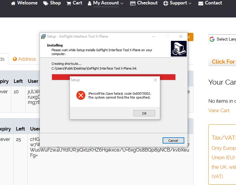

Thanks for resetting my count.
Downloaded and installed GIT. Got the attached error message during install but everything seems to be working. I will download the zibo profile and see how it goes.
Will let you know. Any thoughts on this error message???
