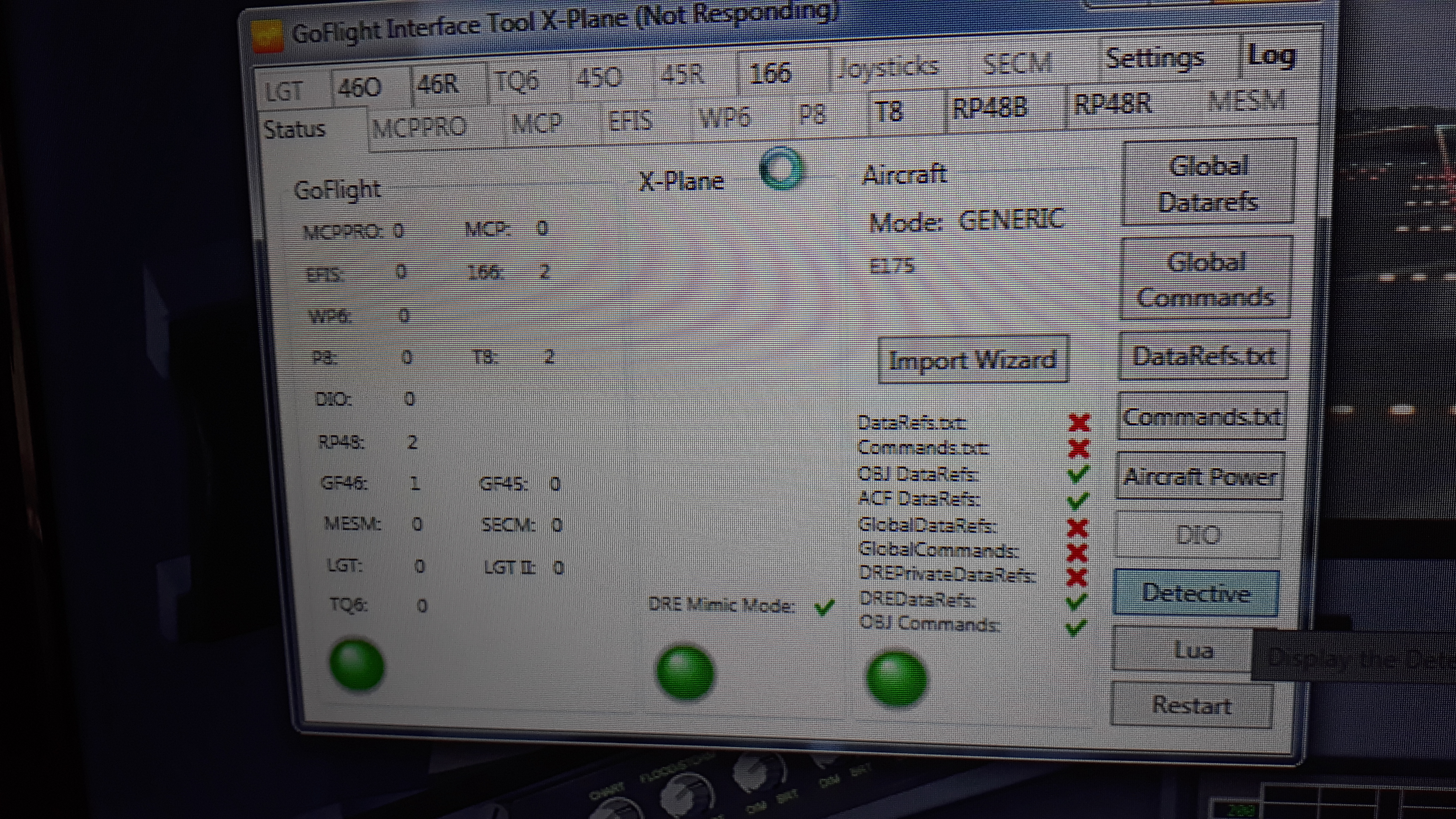

  • I have installed the new version software. I am still having the same issues, as soon as I load the software and try to assign a few commands the software freezes with Not responding on the top of the window and the program closes.

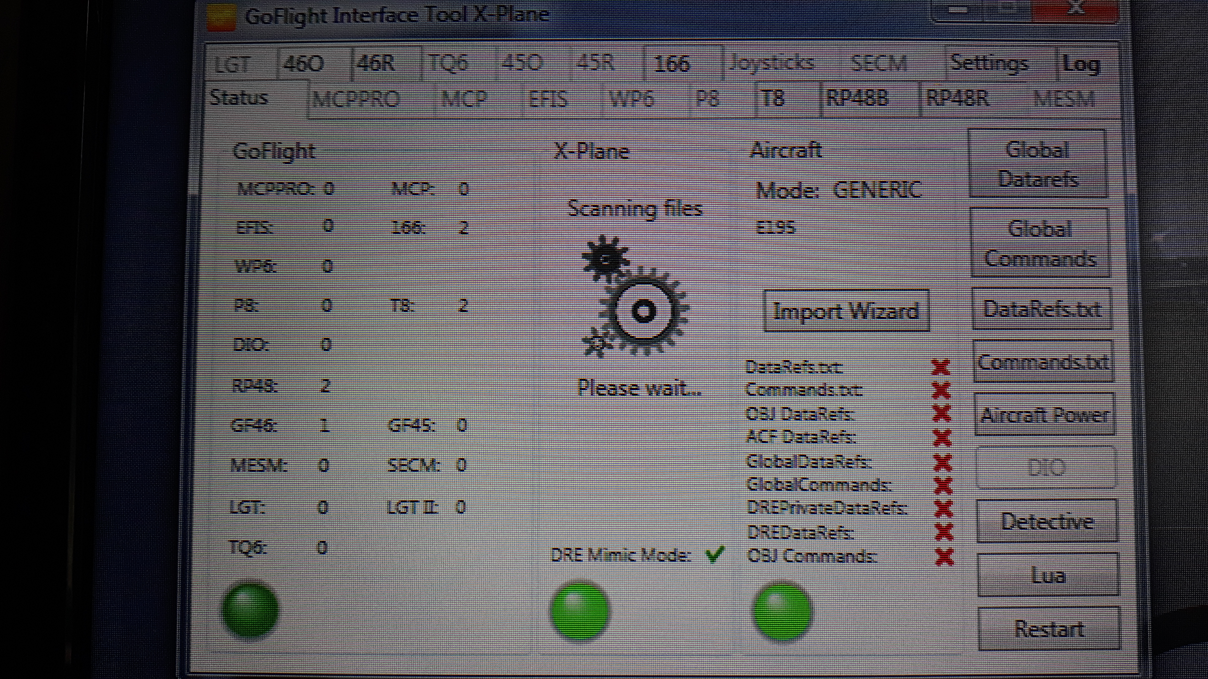

    Does the aircraft LED blink continuously once the plane is active?

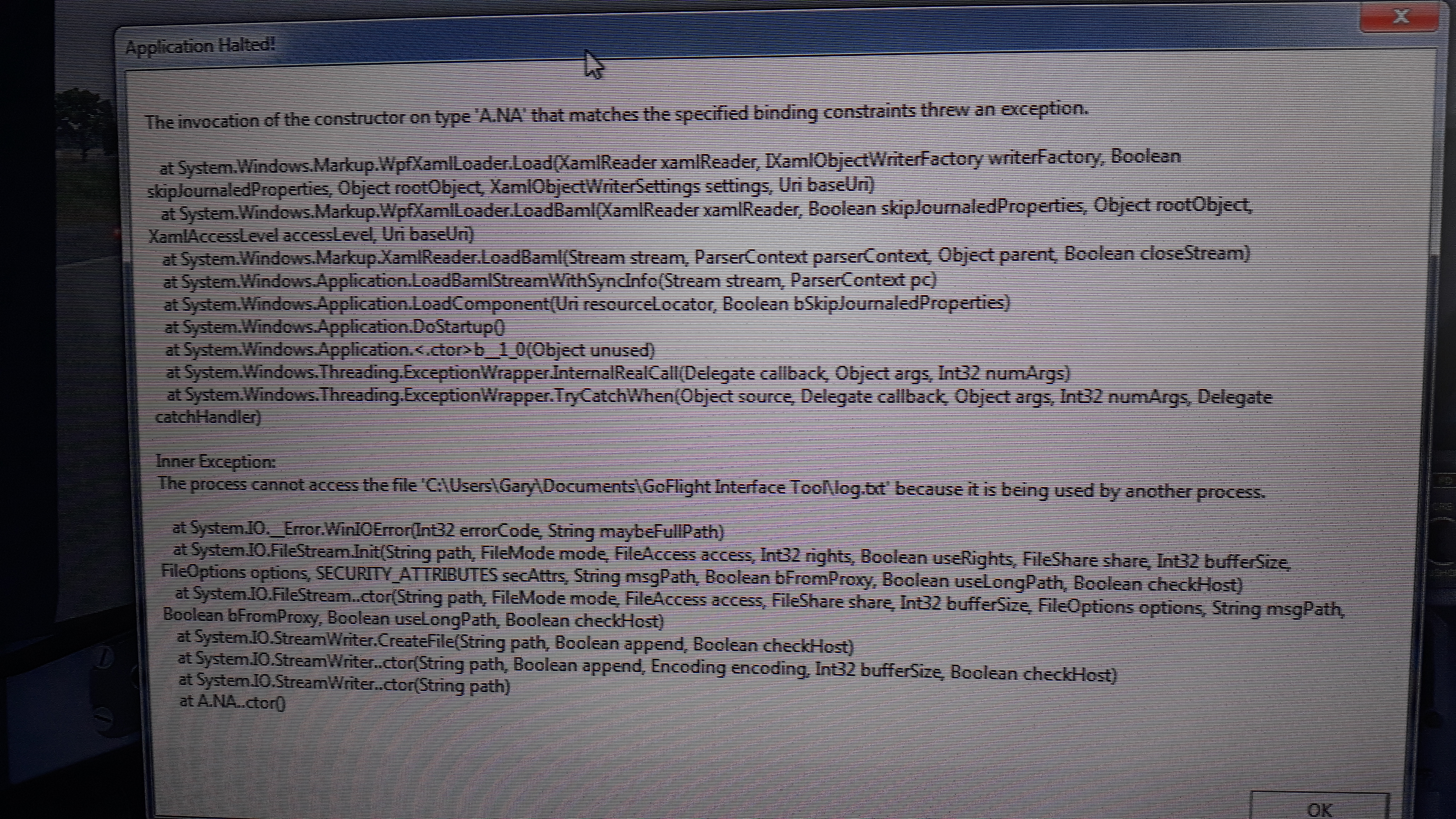

    Do you have a screen dump of any error message GIT throws up?
  • Steve,
    No the aircraft green LED stays steady no blinking. Also all the red x's stay red with no green ticks as when I use the B737 or C172.
    No error messages appear either.

    Ok, do any datarefs and commands appear in the combo boxes on any GIT config tab? IF so are any aircraft specific?
  • Steve

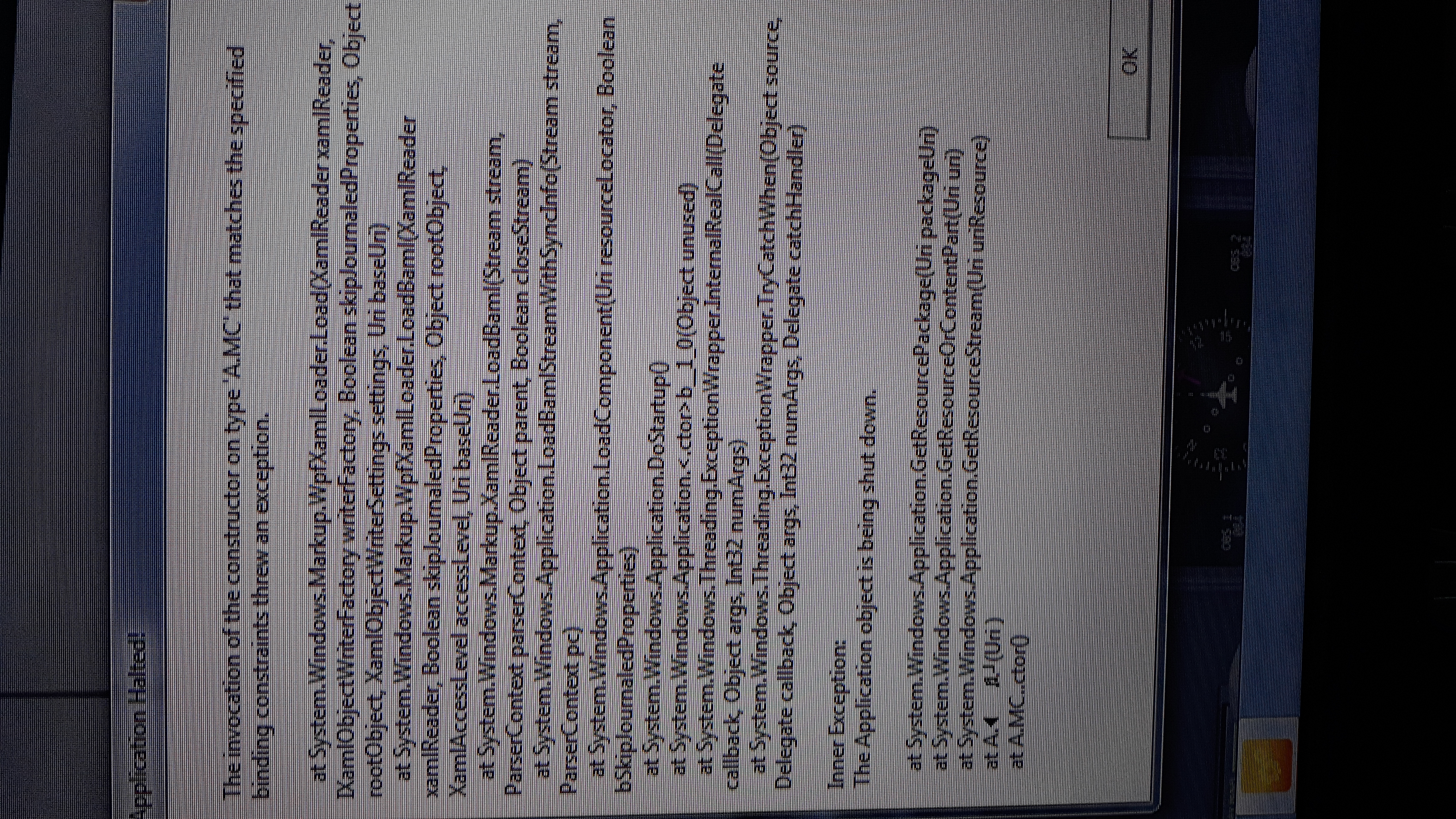

    I have tried the older Embraer 2.3 version with polypot software version 2.0.3 but still no luck connecting. An error message did appear for version 2.4 of the Embraer. Xplane just lists the aircraft as GENERIC and then E175/E195 underneath.
  • OK. Try the latest GIT with the Embraer and tell me any datarefs and commands appear in the combo boxes on any GIT config tab? IF so are any aircraft specific?
  • Steve,
    I have used Software version 2.0.14.1 with Embraer 175 V2.3 and Embraer 195 V2.4 . Both aircraft have options to assign commands for Xcrafts/EMB. I am attaching a copy of the log for both aircraft. The progam became non responsive and closed aswell.
