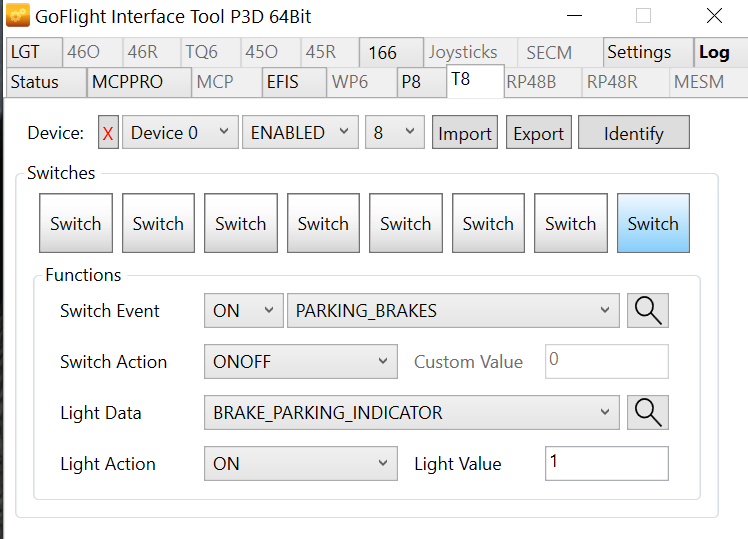

I removed that command from the GFConfig program and tried to assign the brake via GIT. But I cannot get it to operate both on and off. It will engage the brake but not disengage it. I consider myself reasonably intelligent but cannot even get it to perform a simple command. See attached screenshot for my settings. Please advise what I'm doing wrong. This is with a different aircraft - Xtreme Solutions Learjet 25 that uses the standard parking brake command.
Ray (Cheshire, England)
With the NGX use EVT_CONTROL_STAND_PARK_BRAKE_LEVER with a Switch Action of MOUSELEFT_WITH_OFF
Light Data is DATA_CTLSTD_LIGHT_PARKING_BRAKE with ON and a value of 1.
