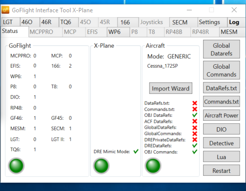

3. X-Plane Version in use 11.0.32.1 -
4. Capture of GIT Status Attached

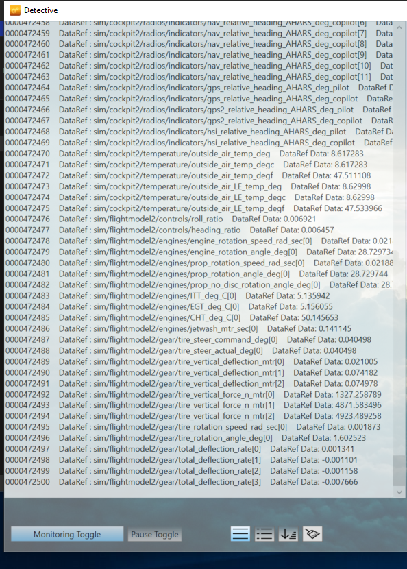

5. Capture of Data Reference monitor (runs but no connection to hardware) Attached
6. No connection with any of the 9 GoFlight modules for the 172's

By configuring the hardware do you mean with the "Goflight config" or a process within the GIT software??
All the modules are enabled in GIT,

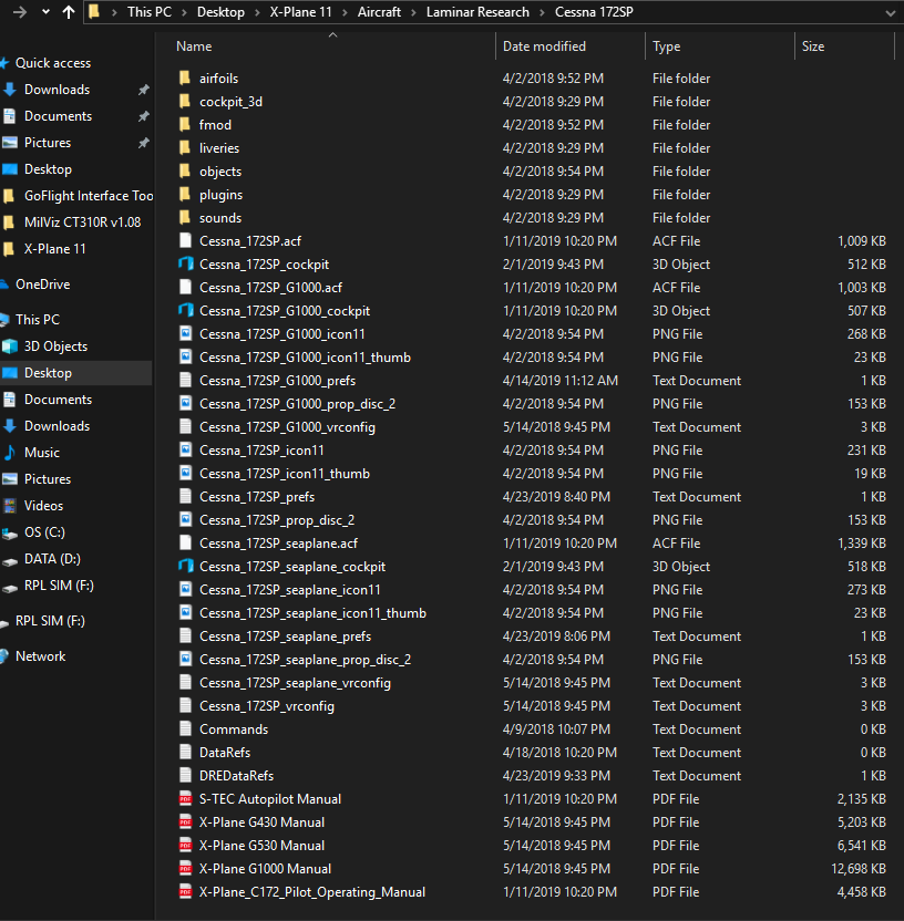

When any of the 172"s are loaded the Goflight console is totally inoperative, the QT6, parking brake work via x-plane joy stick, and the Brunner controls work fine. I have attached a capture of the X-Plane aircraft directory, none of the aircraft in this directory work !!. I thought it may help to flag some issues.
Thanks for looking into this for me. Much appreciated.
Rene
You have to configure GIT. All aircraft need to be configured unless there is a config available for download in the Downloads section of our website. Please see https://www.pollypotsoftware.org.uk/support/user-guide/goflight-interface-tool-x-plane/45-beginners-start-here/150-beginners-guide.html
