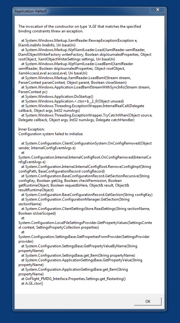

Un- and reinstalled GFConfig and GIT - GIT now shown in menu bar AddOns tab with (only) restart function available.
LUA non operational:
20:53:55 LUA Processor: Pipe Connect Exception - Could not connect to the server within the specified timeout period
20:54:01 LUA Processor: Pipe Connect Exception - Could not connect to the server within the specified timeout period
20:54:07 LUA Processor: Pipe Connect Exception - Could not connect to the server within the specified timeout period
20:54:07 LUA Processor: Connect Exception - Unable To Connect!

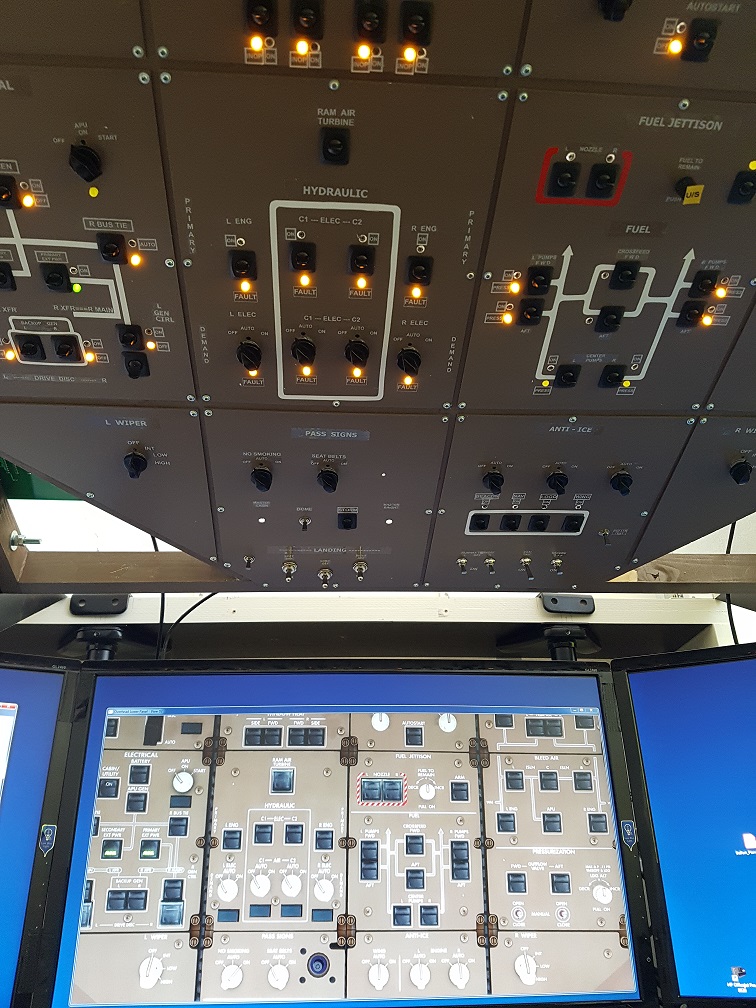

Just one thing remaining that makes me a bit cry: When I load my 777-200LR in P3d in a cold and dark status - most - but not all - of the LEDs of DIO boards are lit!!!! (ON ones as well as OFF and FAULT ones)
Looking at the virtual OHP everything is off, and all of my OHP lights are assigned AND TESTED to fit the virtual OHP.
The only way is to start the plane into flight configuration, switch all the switches from off to on and back to off, shut down the plane again into cold and dark - then all the LEDs are off!
STRANGE, isn´t it? Do you have any idea?

Log says: 11:52:53 Synchronising Switches & Selectors Complete...
attached the log as txt and a pic:
you can see many FAULT lights (hyd, fuel, window heat,...) on which should be off in the actual state as seen in the pic`s lower area (virtual OHP)
Only the green ones are supposed to be on - meaning 2 groundpowers available.
Done 3 times, always the same - but all light-functions are totally ok during flight!!!
If you can solve this, then you are my king!

e.g. Hydraulic Left Engine Pump switch: EVT_OH_HYD_ENG1
ON light (white,working ok) DATA_OH_HYD_SWITCH_PRIMARY_ENG_PUMP_LEFT
FAULT light (yellow, on in cold+dark) DATA_OH_HYD_LIGHT_PRIMARY_ENG_PUMP_FAULT_LEFT
They´re assigned in a way that the white light shows the switch-position (ON/OFF)
and the yellow light is on when the pump doesn´t work or is damaged
When Plane is powered up both lights act perfectly: white shows switch-position instantly
and yellow acts like in real life with the delay from the hydraulic system diagnostics!

I forgot to write down that
action = ON to both LEDs
Value = 1 to both LEDs.
tried Action = ON GREATER THAN / Value 0.7 - to a fault led, made no difference, even with restart of SIM and GIT.
Pls. note my update: all Light functions are totally perfect during powered up plane (taxi, takeoff, inflight, landing). As soon as I shut down power all white ON lights switch off as they should, but the Yellow FAULTs stay powered up as they should not!
Alex

I have just raised a support ticket with the PMDG about this. The issue is that the PMDG SDK does not set the variables from 1 to 0 when the battery power is cut hence your lights stay on.
